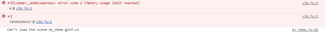

    XZLoader._emDecompress: error code 2 (Memory usage limit reached)
    Bin file The glft file was compressed by xz, initialized init, and executed. But there was an error

    you are probably exporting very large scenes. You can edit the memory limit in the manager/server.py script.
    Find the line
    SERVER_MAX_BODY_SIZE = 256*1024*1024
    and edit it to something like
    SERVER_MAX_BODY_SIZE = 512*1024*1024

    I did as described, but I get an error. Blender file size is 2GB and empty file size is 700,000kb. The glft file has been loaded and created. But the file size is 10000kb, I don’t know why it is so big. Reduced mesh and material as much as possible.

    then you might try to specify even bigger number, say 1024
