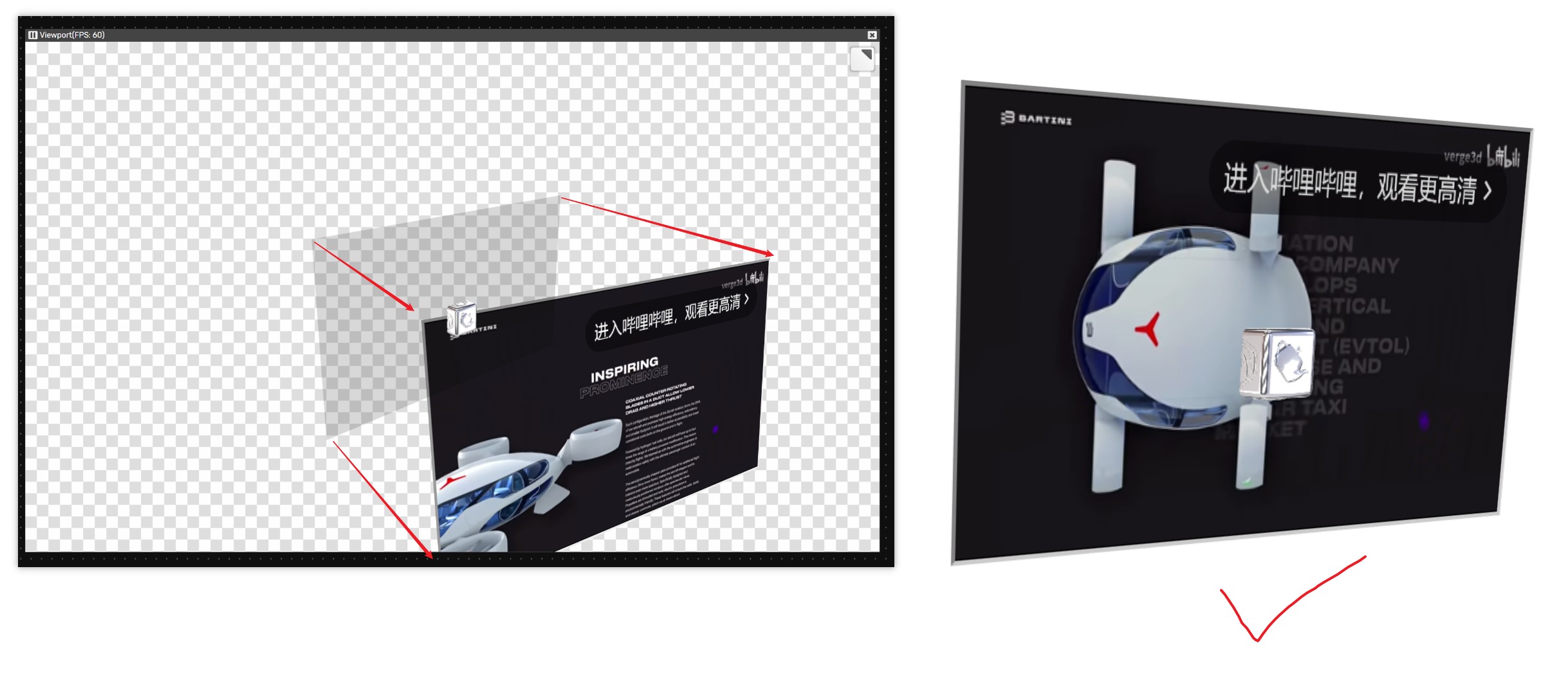

    I tried using CSS3DRenderer to render an iframe video, and the final result is displayed correctly. However, in the viewport of the Verge3D editor, there is misalignment unless the viewport size is enlarged to almost fullscreen. To solve this issue, I had an idea of adding an event function to the viewport similar to “window.addEventListener(‘resize’, resize)”. Since there is no documentation available for this specific part, I would appreciate any hints or relevant code that could help resolve this problem. I have attached an image showing the misalignment.

    You’ve set the wrong size for mixerContext.rendererCss.
    See this demo https://cdn.soft8soft.com/demo/blender/htmlmixer/htmlmixer.html
    #82400
    Starting from Verge3D 4.10 this can be done with Puzzles. See here for more info.
