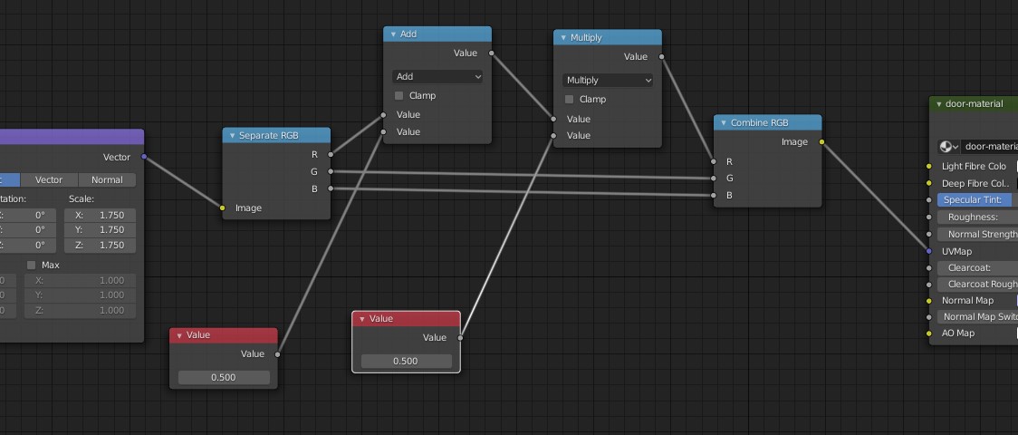

    I Have been working on a kind of configurator solution in which i need to scale some part :
    For example a plane 3d object, this plane has a material affected to it.
    for example we need to change it size scaling in only X axes. from 1 to 2 to 3 and then to 4.
    The issue i faced is when you change it scale the material get stretched. i know there must be a solution for this, and I don’t know how to make it works in blender/and Verge3D. on other software it’s the cubical projection mapping.
    PS: I Tried the texture coordinate making it to object and tried generated, and uv, but nothing of this worked properly.
    Please is there any way to do this ?
    Thank you :)

    I guess it should be possible to adjust UV coordinates on the material level. Each time the model is scaled, you can set a different multiplier using the set value puzzle.

    Hi dear Yuri, thank you alot for your answer, but I tried to find a way to implement the value node, but i couldn’t success, to find it in the value puzle, maybe i didn’t a correct way in the material node editor,
    here in the file attached please a sample of material has a mapping (example 1.75) i would like to control the X Y Z value in the puzzle, please is there any screenshot you can send me back to do this. ?

    The set value puzzle only works with an explicit Value node. You might want to add a Math node just after the UV output and scale the UV using a Value node as factor.

    Thank you Yuri for your answer, i’m still struggling to find the best way for implementing the set value node with a specific scale i tried to make separate XYZ, but can’t find a way, please here is attached the material

    Hi, you need to use such setup. Add for Location and Multimply for Scale.

    @Mikhail !! Thank you alot! i’m really so thankful this saved my life with all material for each size, i saw also the object projection(cubic texturing) doesn’t work with web real-time rendering at the moment
    Thank you again!
