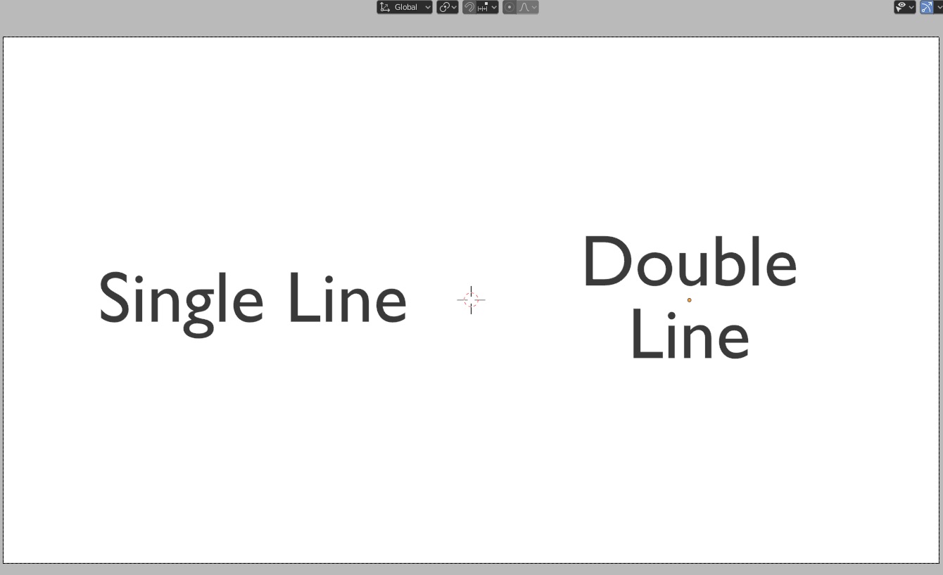

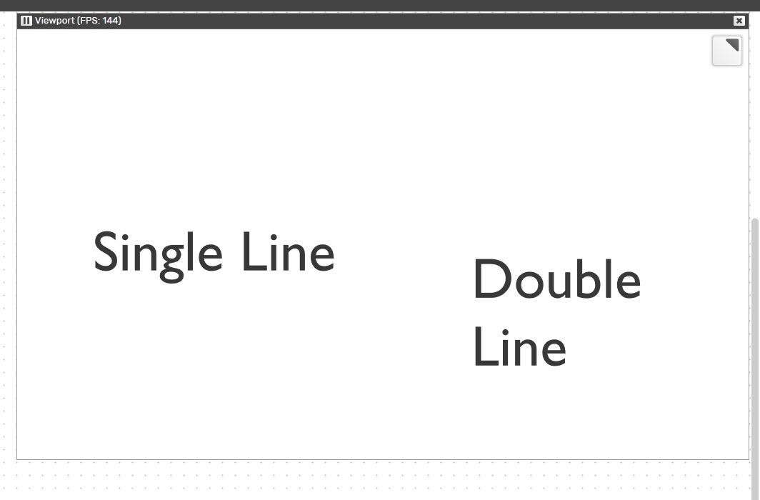

    Hi, currently using Verge 3.3.1 and trying to get editable text to match the alignment set in Blender. Text is set to centre aligned both horizontal and vertical in Blender. Horizontal alignment looks fine but vertical gets lost when moving to verge, and looks like it switches to top alignment.
    Most noticeable on multi-line text – see attached pics
    Any idea how to fix?

    most likely these advanced options are not supported. You can try to convert your text objects to meshes before exporting, or use texture-based text instead (which can be creating with this puzzle)

    Hi Yuri thanks for the reply. We need to keep the text editable via puzzles so have to keep them as text objects, and need the geometry to create a bevelled effect so haven’t been able to use a texture-based approach. Will see if we can find some other workaround, but would be great to see this feature added in future if ever possible. Thanks
