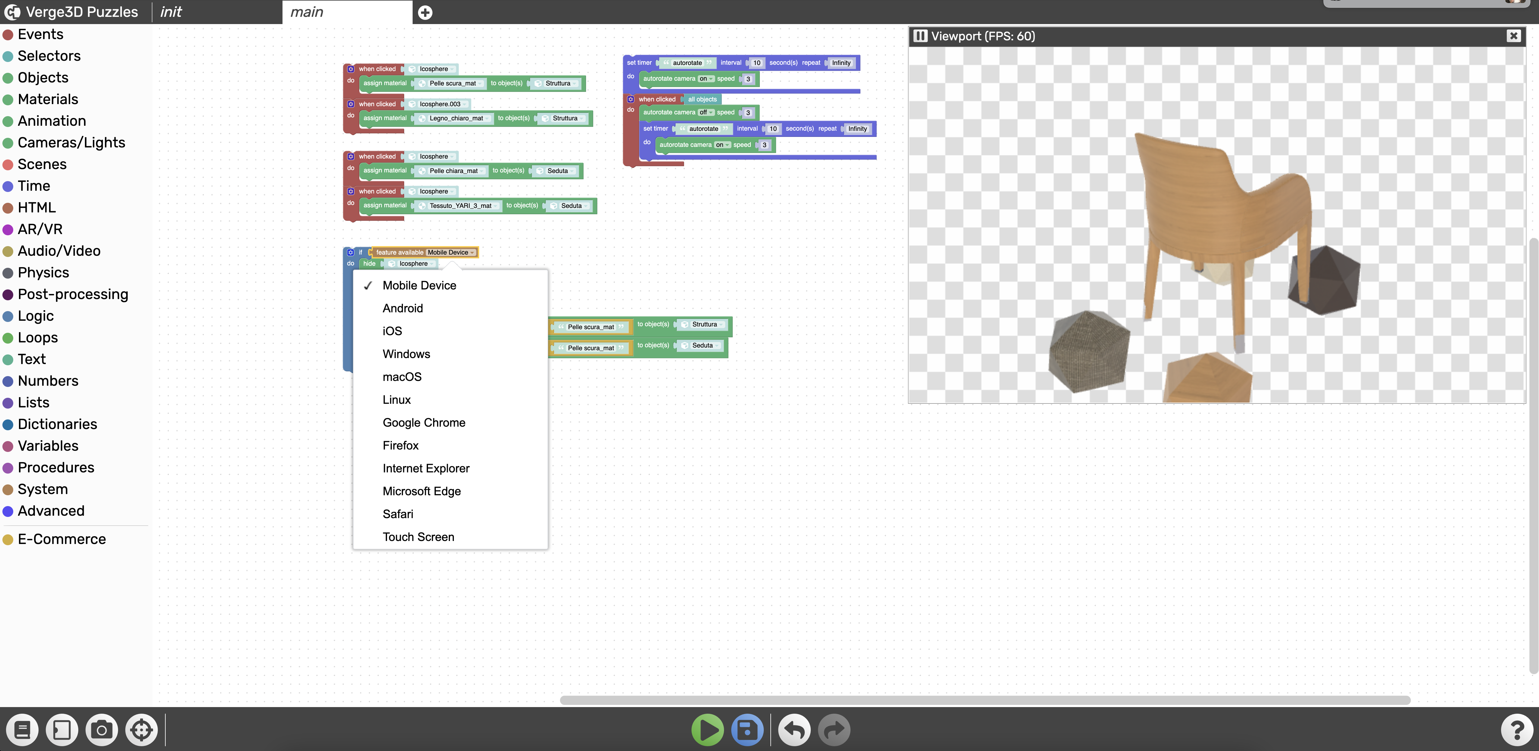

CustomerHi everyone, im trying to develop a configurator connected to Woocommerce, but once opened the dropdown menu in “feature available” puzzle located in the “System” section, the “Woocommerce” option is not appearing.
Consequently my configurator is not working.
Thanks in advance for your help!

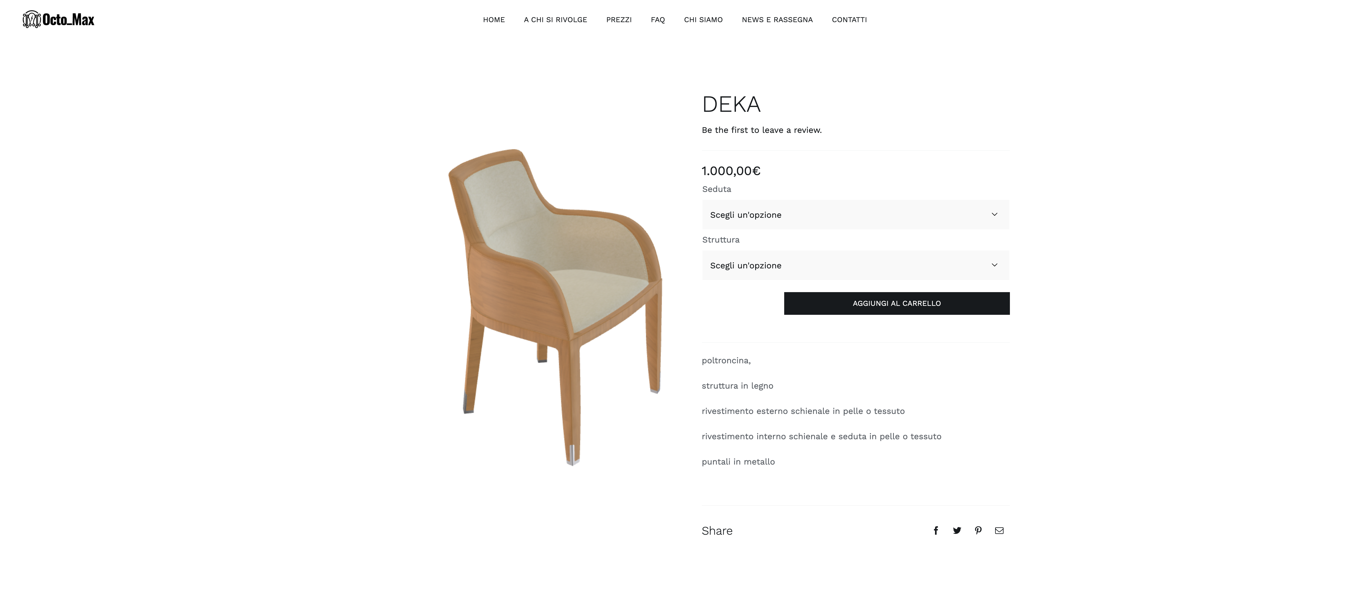

Michele, can you please share the screenshots of your woo commerce configurator.So I can help you to solve it :)2021-10-15 at 9:43 am #46199Michele Campagnoni
CustomerHere’s the screenshot (it’s just 1 page by now)

2021-10-15 at 2:31 pm #46212Michele Campagnoni
CustomerI haven’t designed it yet for responsive layout, the main problem by now is that the texture that can be selected into the configurator dont modify the 3d model in WP

harisCustomerSorry for this, the way to solve this issue is if you know how to use chrome debug tools you need to copy the dropdown selection options “id” and in verge 3d puzzles in “HTML” tab select on event of click puzzle
paste you id next to elem, for more information let me know, i will help you :)2021-10-18 at 1:53 pm #46276

Im running Chrome 94.0.4606.81 and Big Sur 11.6
