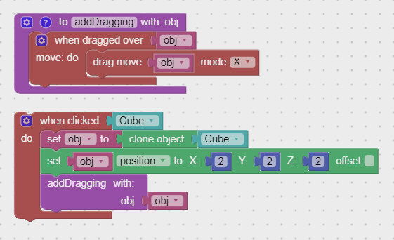

I noticed that in your demo only the last cloned object can be dragged but not the previously cloned ones. This is because in the “drag move” puzzles the object that should be dragged is obtained from the “boardclone” variable, which changes every next click. To properly assign a “drag move” handler on every cloned object you can use a “function” puzzle with the drag logic implemented inside it:

I will read up on that. Thanks for the help btw with the cloning procedure.. I had just started experimenting with that and that tip to assign dragging really helped.

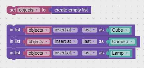

As a follow up, how would I create an array out of that clone ‘ojb’ variable? Or is it already an array object that I can than iterate through?
I need to use puzzles from the “Lists” category, for example:
