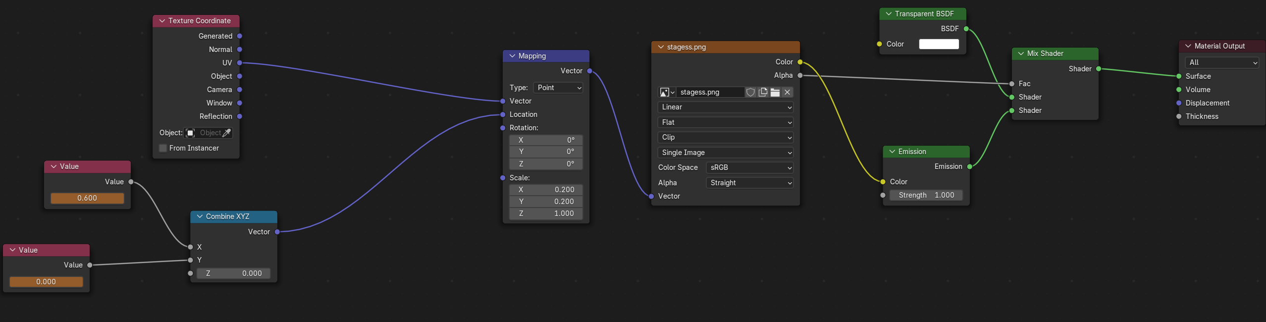

https://www.youtube.com/watch?v=fuZFuY5aqRIAt the start, how do we get the offsetX and offsetY attached to combinexyz? In Blender 4.2, it seems to be missing
2024-11-12 at 2:31 am #78551kdv
Participanthow do we get the offsetX and offsetY
These are just two Value nodes with changed labels.

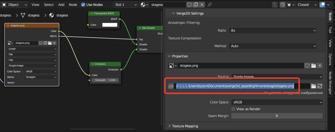

2024-11-14 at 3:30 pm #78752
c4ccCustomerSorry for the late reply, I finally figured out the problem, the sprite sheet was too big in size (82.7 mb, and 48,000px x 27, 000 px dimension). I used gimp to cut the file size in half, and now, technically, I can view in on the browser.
Now, another problem is, in the browser, it scrolls horizontally. I just want the file to be stationery while the animation is playing, like a proper gif. Also, any way to reduce graininess and to make this sprite sheet sharper?

2024-11-14 at 3:51 pm #78758
c4ccCustomerI’ve already packed the image file here:
https://drive.google.com/file/d/1mjGuCxFvqD4MRNqDllRZmZqBpxPFwT95/view
2024-11-14 at 3:59 pm #78761
c4ccCustomerI’ve packed the new blend file here
2024-11-14 at 5:11 pm #78764
c4ccCustomerI notice in Blender, the texture sprite sheet stays in place while the animation plays. But in browser, the texture scrolls horizontally. How to keep texture in place while animation plays?
