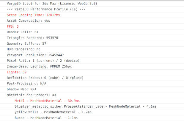

2022-01-27 at 6:23 am #48855
Yuri KovelenovStaffHi Ger,
Thanks for sharing your new project!
I’d like to point your attention to some issues that you might address. If you run the performance profiling feature, it will show that there are 59 lights on the scene (which is an overkill), and the shader called “Metal” is rendered for too long. See the attach.
2022-01-27 at 8:43 am #48859gf3d
CustomerHi Yuri,
again…I know it has lots of lights…..But its meant for more high performance PC´s…..at my PC it starts within seconds…runs with
60FPS and has no problem with shader performance….But thanks for your comment…
Greets
Ger
