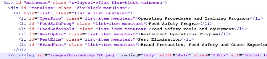

    I’m making a simple app:
    https://v3d.net/teh

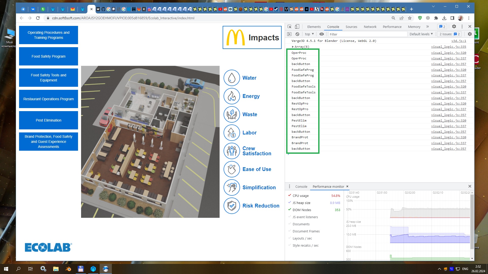

    some of the buttons on the left work, some don’t. In the puzzles, I’ve made a on click using the target.id to get the id, and among other things, print it to console. Some of the buttons registers a click and moves the ‘info’ window over (a back button appears to move it back), but the id doesn’t print and it doesn’t change the text in the info window – it’s a blank line in the console. Several of the other buttons do work, include changing the text in the info window.
    Why won’t some of the ids register on the console?
    Editing to add: which button works and which doesn’t seems to change every time I open the app.

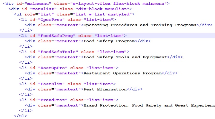

    Everything is registered correctly. But you have other HTML elements inside (and over) the blue buttons. If you click on texts it writes an empty string to the console log (your texts have no IDs). But if you click on the button itself (some where on the corner) you will see that it works.
    The trick is that when you click on the text element you also click on any other element under this text (the blue button, canvas, v3d-container, document and window). But the target ID is the uppest element under the pointer. Sometimes it’s good, sometimes it’s annoying but that’s how it works in browsers :unsure:

    That’s what you have (<div> inside <li>)
    That’s how it should be to work as you need.
    https://v3d.net/tel
