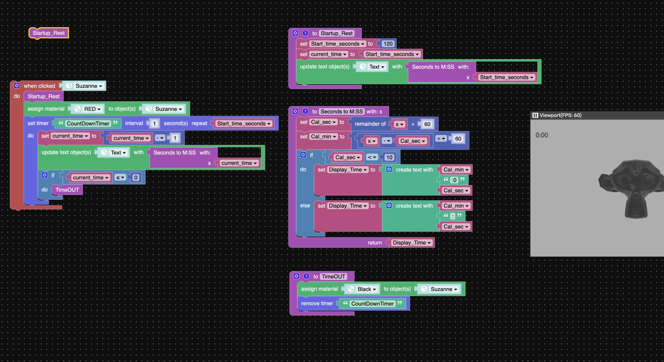

xeonCustomerWell…there are so many ways to do this. You could also do this with HTML/CSS or JavaScript but since you specified Blender I am guessing you want to use the text object in Blender in addition since you specified Verge3d and didnt specify any other way…I guessed you were wanting a way to do this via puzzles.
Since this is for a game I figured you need a way to trigger the timer. In this case I am using the “when clicked” puzzle on the monkey mesh.
There is a “Startup_Reset” procedure that defines the time, in your case 2 minutes (120 seconds) in the “start_time_seconds” variable adjust the “start_time_seconds” to any time you like, in seconds obviously. Its also the Rest function when time runs out…you can press the monkey and restart.
The second procedure “Seconds to M:SS” just converts a given seconds input into M:SS format for visual display.
After the time runs out….I am sure you will want to trigger something to happen. So there is a “TimeOut” procedure that changes the material of the monkey and removes the timer.
Hope this helps.

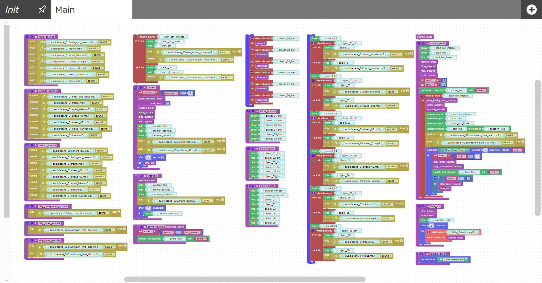

I am creating a simple children’s Q&A game with a countdown timer and score counter. With xeon’s help,
I have managed to get so far, but I really need some advice on how to improve the game.
At the moment, the game only has one scene, but what I would like to do, is load new scenes and keep track of the score as the new scenes are loaded and unloaded etc.
I hope that makes sense.
Here is a direct link to the game play so far:

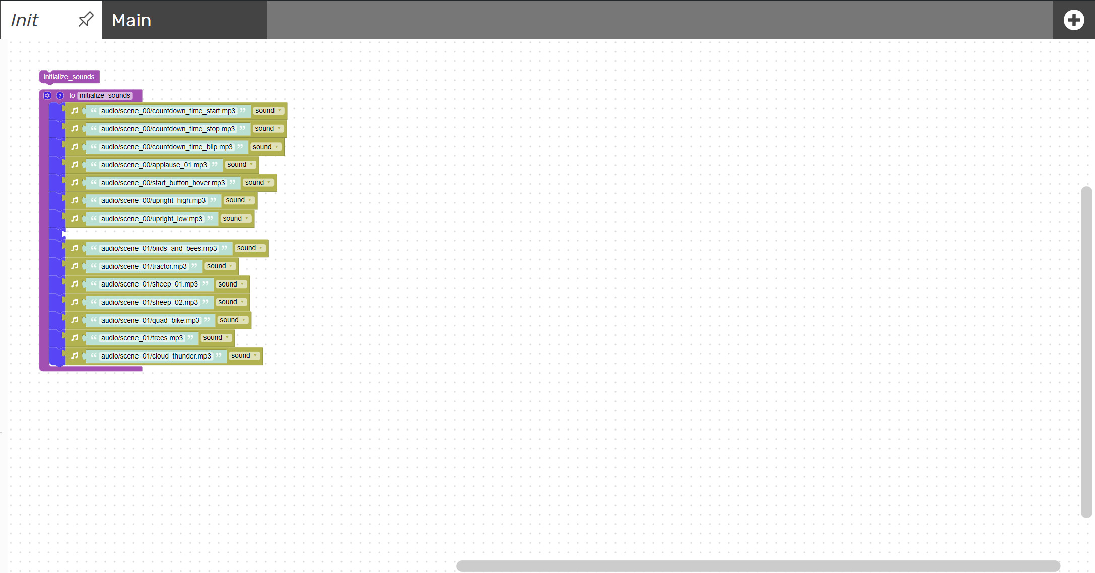

https://cdn.soft8soft.com/AROAJSY2GOEHMOFUVPIOE:f987943ffd/Kids_Questions_02/Kids_Questions.htmlI have also attached two screenshots of the puzzles that I am using and any advice on how to reduce the amount of puzzles would be great.
I am new to verge 3d and I have very limited programming skills, so any advice would be much appreciated.
Thanks in advance.
2024-04-17 at 12:40 am #72351
xeonCustomerGiven the graphics style you are going for you could use a sprite sheet and not have to load any scenes.
