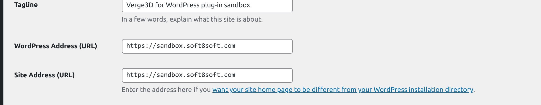

    Please check in WP settings that website URL contains HTTPS:
    #53402
    Robert Drew
    Yea the https is disabled ill talk to the client and see if they can upgrade it. Thank you for your help!
