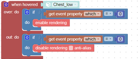

    Really nice one :) , just a pro tip disable rendering when the camera is not moving it will make the performance and experience better :good:

    Disabling rendering on when hovered out makes rotation rather jerky. It disables rendering while I’m trying to rotate the scene. Looks not good. Check if the mouse buttons are not pressed.

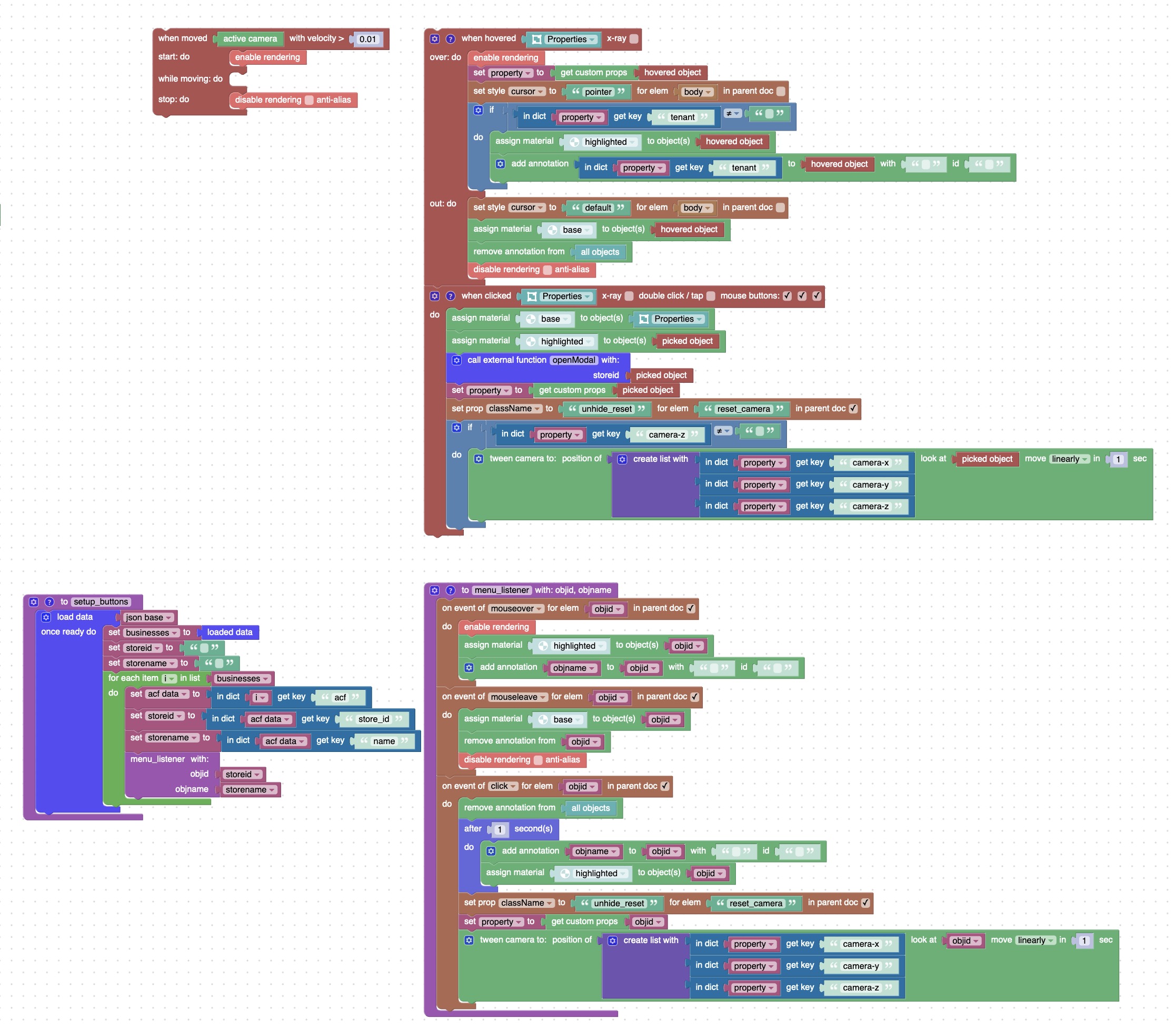

    I have noticed the jerkiness as well but when I try what you suggested kdv77kdv the annotations go to the top left again.
    Here is the puzzle configuration I’m using.

    Sorry, but that removes all my annotations when hovering.
