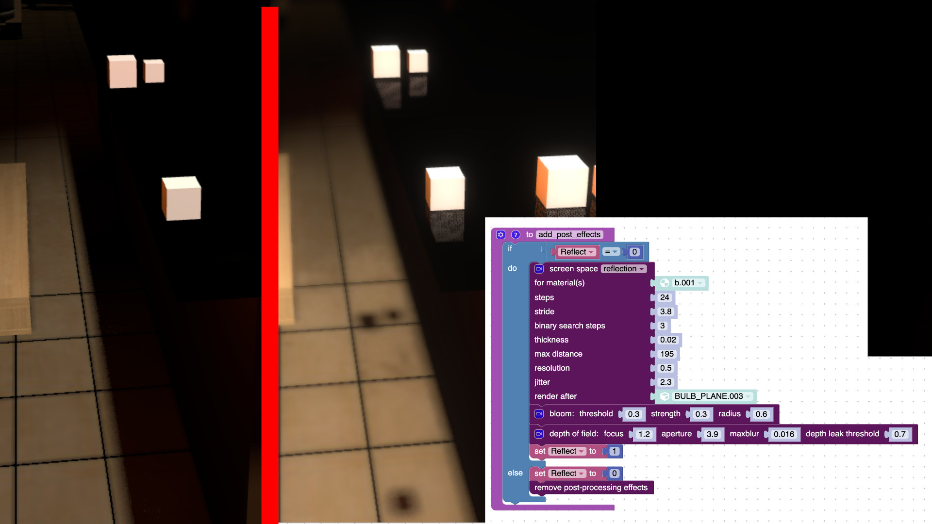

    Hi there, this scene was originally created using V3.5 and was updated for 3.6. This particular project has a simple button that turns on some post-processing effects. The attached image shows the scene on the left with no effects…the image in the middle is with the post-processing effects activated. Note the shadows on the small cubes on the floor. They shouldn’t be there when post-processing is activated.
    The puzzle for the post-processing is also in the image.
    The reflective surfaces is the black bar counter top.
    The question is…. is there a method to get rid of these shadows?
