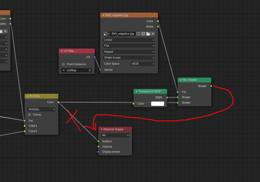

    hi guys, are these the same answers? i dont get it i have a value node connected to a merge node, but it dont show up i puzzles ??
    #30786
    can you attach here a screenshot of your material?
    #30909
    michael90g
    Hi Yuri, sorry for late reply, here is the screenshot,,
    #30912
    Shader must be also connected to the output node.
    #30921
    michael90g
    ?? it is, isnt it? did you see the screenshot?
    #30922
    You connected not a shader, but a mixcolor node. You need to do it this way.
    #31075
    michael90g
    thanks! i got it working now :good:
