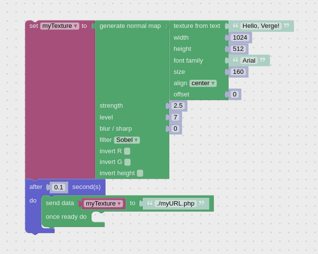

Yuri KovelenovStaffHi,
Try the following workaround:
2019-10-07 at 10:41 am #19911hoody

Yuri KovelenovStaff2019-10-07 at 2:14 pm #19935hoody
ParticipantHey. I tried that (tried with 0.1 ; 0,5 and 3 s) but it does not seem to make a difference.
