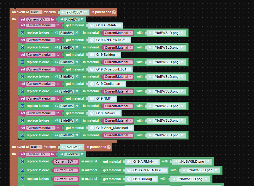

    Hello, I have a setup where I am trying to replace the texture in the currently applied material.
    My project has 40+ textures that can be applied to the object and a couple different variations of textures that can be swapped out into a image texture.
    I cant figure out how to setup my puzzle to work. I tried creating a variable that gets the current material applied to the object and the current texture in that material and then using the replace texture puzzle, but I dont think i set it up correctly.

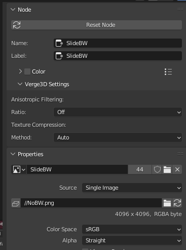

    And related, can I name the texture node in Blender and use that to swap textures in puzzles?
    I have attached images of the puzzle as well as the node in blender.
    #55195
    what’s wrong with your puzzles wnen replacing textures?
    Is SlideBW texture the same image for all selected material or you’re trying to use it as a variable to get a material’s texture? It won’t work as a variable, it’s just an alias for NoBW.png.
