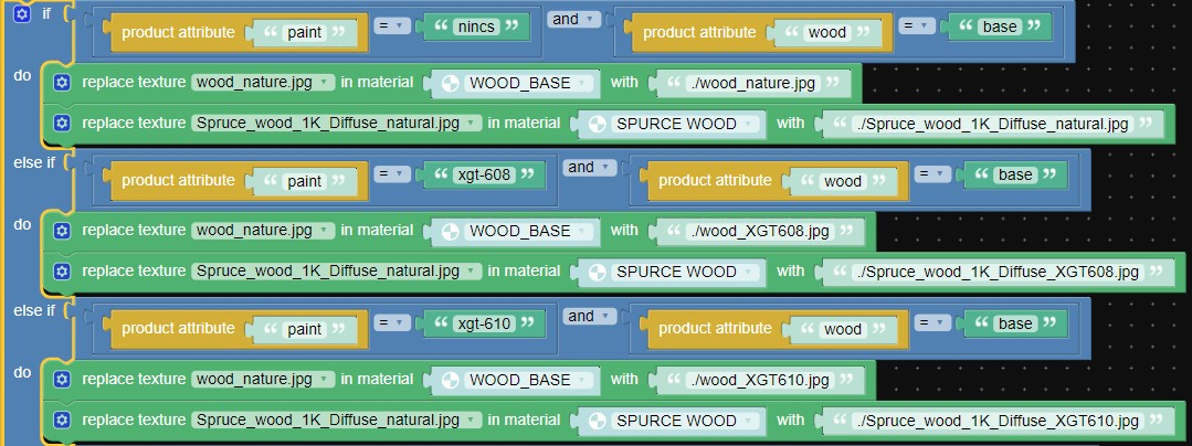

    I have a “replace texture” puzzle, which is sometimes not working accordingly. Please, see attached image.
    The issue: When I select attribute “xgt-608” not every time changes the texture and it stuck with the original “wood_nature.jpg, however, I should see “wood_XGT608.jpg texture. As you can see there are 2 replace puzzles for the action. Sometimes change both correctly, sometimes changes just only one but sometimes completely ignore it.
    I use this method, because I have a multi-object with different materials, and I need to change just one of them.
    Do have any idea what this problem is, or could tell me any suggestions on what should I do?

    Please, share the project in simplified version.

    Meanwhile, I have already solved it. I added all the replace textures for separate objects, in the scene somewhere that is not visible to the camera. In this case, all the textures are all loaded at the start, and no problem anymore. :)
