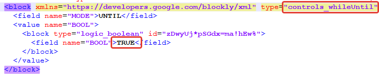

    #67588
    Open visual_logic.xml with your favorite text editor Notepad++, find the block controls_whileUntil (F3) and replace FALSE with TRUE inside the block logic_boolean
