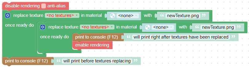

    *some textures are changed
    *the size of the objects is changed
    *some textures are recalculated by converting “string to texture”
    note that the replace texture puzzle is a function that waits for an image data being loaded before replacing it. so you’d better use “once ready do” slot
