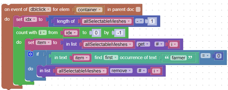

    I can do this successfully with straight javascript, but anyone have tips/tricks with just puzzles?
    Eg, I have ‘for each item in list’ with some conditional logic and if a condition is met, I want to remove that item from list while its still iterating.
    #68032
    Hint one: this puzzle won’t do.
    This puzzle can remove items from lists but it requires an index. That loop puzzle can’t provide it.

    KDV, do you have any ideas on this? I would like to cut out the hole on the main and the individual items (studs in my case). I’ve tried manipulating list and can get it working on all but without the refresh. I’m thinking if it is possible, I’ll need something tricky like this.
    https://v3d.net/q02
    What do you think? Is this possible?
    #68585
    Show your puzzles or zip and upload the app. Actually, I didn’ get the point…
    #68725
    Crunch
    a little late KDV but bonus points as that was pretty crafty! :good:
