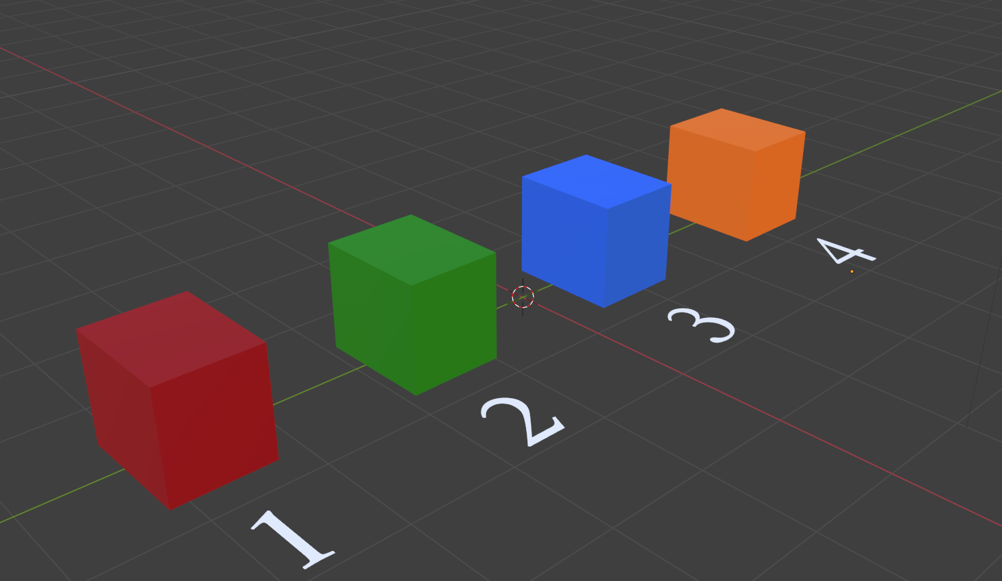

    here is a simple scene made with 4 cubes..
    how do I set up a condition that, user must click cubes in sequence only.
    Initially 1st then 2nd then 3rd & then 4th
    if user clicks 2, 3 & 4 before clicking 1st then it should pop up an error message
    Then second time user needs to click 2nd cube & if 1, 3 & 4 are clicked then it should pop up the error message
    same with 3rd & 4th.
    how to setup a logic?

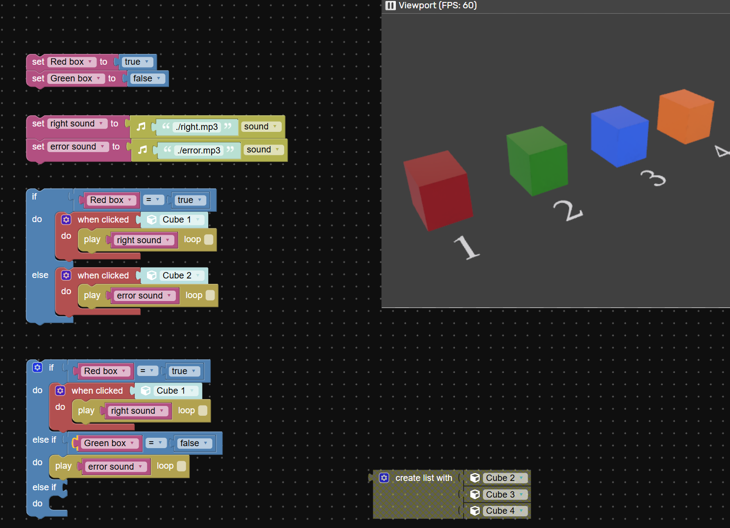

    I have set up a simple puzzles as seen here… for first box it plays well
    but the error sound doesn’t play in both the logic puzzles….
    whats wrong?
    If this stage gets resolved there is as second stage to set but I am wondering how to pass this stage?

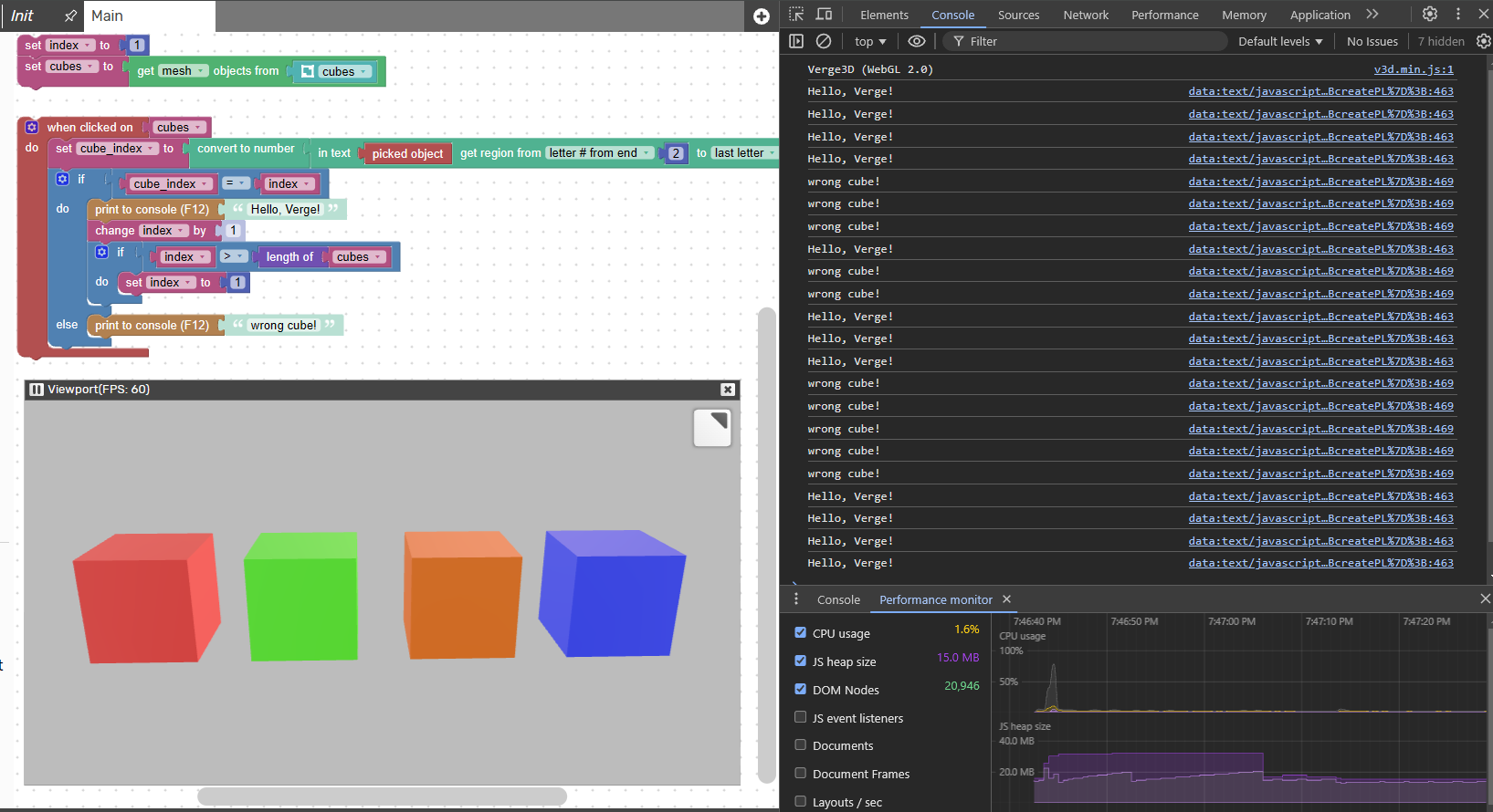

    You might employ the following approach:
    1. Create a list of all 4 objects
    2. Create an index variable that will take the following values: 0, 1, 2, 3 (from object 1 to 4)
    3. Upon clicking on the object, find it in the list (returns position)
    4. Compare position with index. index = postion is OK, index ≠ position is an error
    5. Increase index if no error happened on the previous step
    6. If the index > 3, set it back to 0 (to repeat the clicking cycle)
    Hope this helps!

    We don’t, but the logic can be implemented quite easily. If you’ll have difficulties just output the content of the variables to the browser console with the print to console puzzle.
    #82858
    smth like this will do the job
