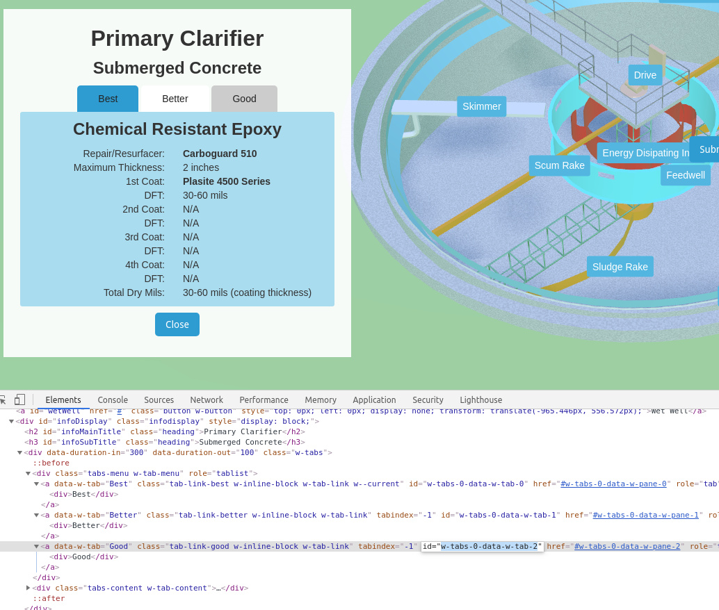

    johngrigni
    #32063
    the app looks great! :good:
    You can open the console with F12, switch to elements and inspect your tabs.
    This reveals that these tabs has ids: w-tabs-0-data-w-tab-0, w-tabs-0-data-w-tab-1 and w-tabs-0-data-w-tab-2, for the first, second and third tabs respectively.
    As such, you can trigger a tab by executing this code:
    document.getElementById("w-tabs-0-data-w-tab-1").click()
    in which you should provide the corresponding id.
    In the preview build of Verge3D 3.4 we introduced the Script puzzle, so you can trigger a tab right in the Puzzles. :yes:

    update: since the Puzzles are executed in iframe, while your UI resides in the outer .html file, the code should look a bit different:
    parent.document.getElementById("w-tabs-0-data-w-tab-1").click()
