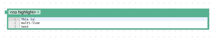

Yuri KovelenovStaffMulti-line and Script Puzzles
A puzzle for typing multi-line text is now available in the Text category. It can be used with all puzzles that accept text as input.

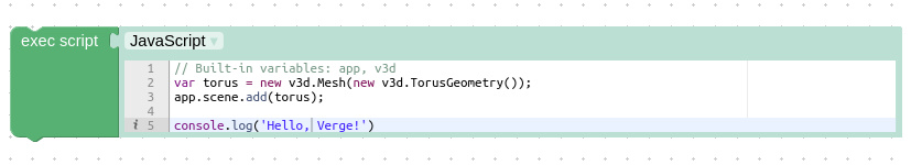

We also implemented a puzzle for executing JavaScript, available from the Advanced category. Coupled with the above-mentioned multi-line puzzle, it allows you to use line numbering and syntax highlighting when editing your code.

GLiFTeKCustomerI was FLOORED when I saw the new JS script text puzzle.
Wowowow!
Thanks guys, for making things easier for the development flow!
EDIT: do variables still have to be “passed” to the javascript text funciton as they would in Call JS app.ExternalInterface, or can they be referenced just as you would in puzzles?
plz share Discord link & on your signature!2020-08-23 at 8:02 am #31876
Yuri KovelenovStaffEDIT: do variables still have to be “passed” to the javascript text funciton as they would in Call JS app.ExternalInterface
yep!
2020-08-23 at 8:50 am #31879
GLiFTeKCustomerEDIT: do variables still have to be “passed” to the javascript text funciton as they would in Call JS app.ExternalInterface
yep!
yuri,
how does one do that?if I’m sending a call JS, i simply include it in the “with”.
when i concatenate two new script text blocks with a variable between, it gives the entire value (which looks like a useful technique elsewhere).
how can one not use call js, use the new txt script puzzles, and still include the variables.
do you have to bounce them to a call js that just takes it then returns it?
thanks!
plz share Discord link & on your signature!2020-08-23 at 1:21 pm #31891
Yuri KovelenovStaffhow can one not use call js, use the new txt script puzzles, and still include the variables.
you can save your variable in some global namespace, for example, or even to
windownamespace.2020-08-23 at 2:21 pm #31893
GLiFTeKCustomerhow can one not use call js, use the new txt script puzzles, and still include the variables.
windownamespace.hi yuri,
so do you mean do that through a call js?
pass a puzzleVar in a call js “with” …to an externalInterface function
then give a window.globalVar… that passed puzzleVar as value…
then it’s accessable in the new script text puzzle code?Visit the GLIFTEK Verge3D Plugins Store!
plz share Discord link & on your signature!2020-08-23 at 2:35 pm #31894
GLiFTeKCustomeryep that’s exactly what you mean.
got it…
with
app.ExternalInterface.makePuzzleVarGlobal = function(puzzleVar){ window.puzzleVarGlobal = puzzleVar; console.log('window.puzzleVarGlobal from ExternalInterface: ',window.puzzleVarGlobal); };console output:
“window.puzzleVarGlobal from ExternalInterface: foo
window.puzzleVarGlobal from Script puzzle: foo”
… maaaaayybee make a special Variable puzzle that makes global variables so people don’t have to do this with every variable they want to use in the script? (could do it in bulk i guess)
the script text puzzle is great.
