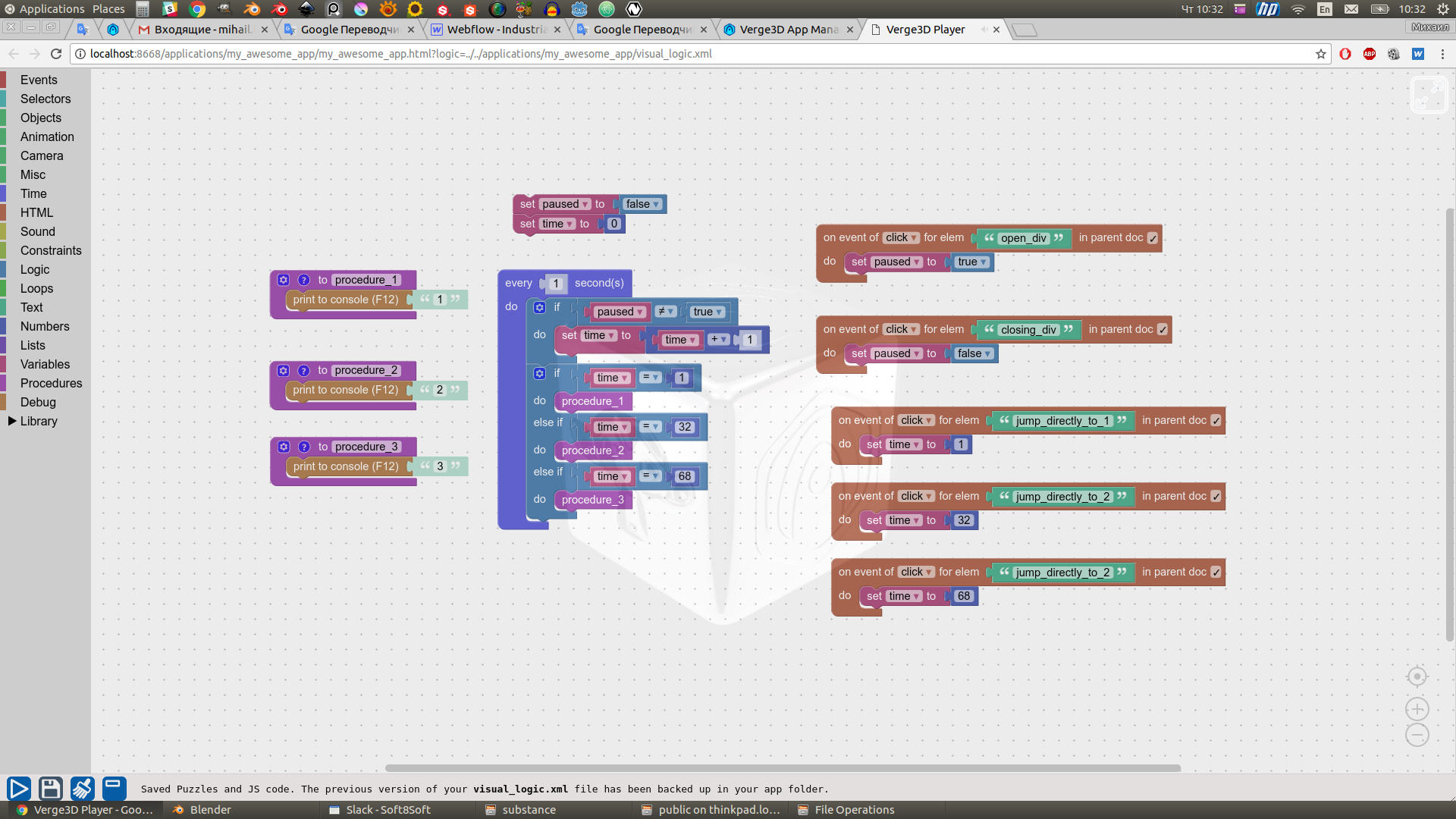

    If I get your right, you need to create your own timer ind do all things relatevly to it, you will be able to make pauses and jump to each step any time.
    Something like this:
    #5668
    vincent
    Thanks very much for your help. I’m working on it.
