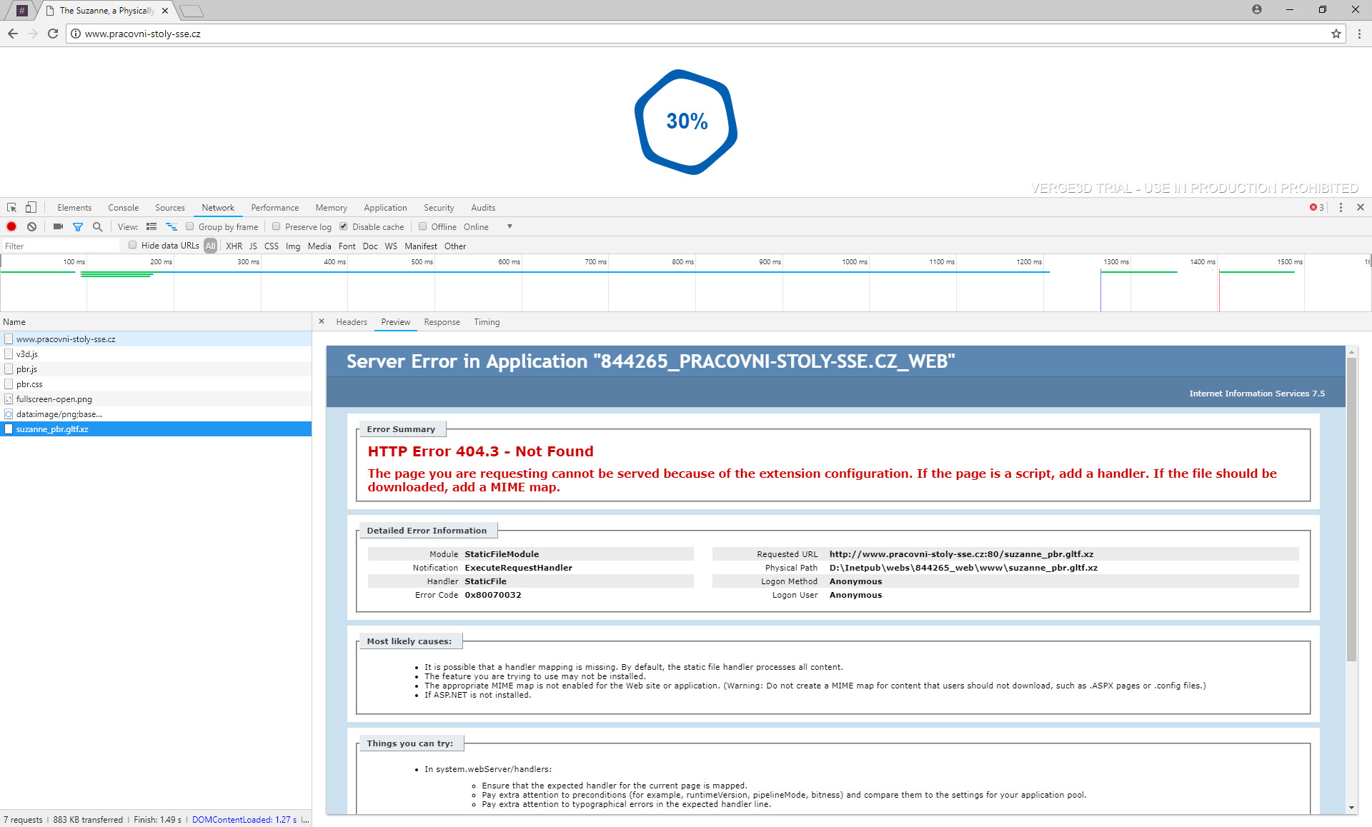

Yuri KovelenovStaffI checked again in the console – I guess your IIS web server requires adding the .xz file extension to its mime map.
https://docs.microsoft.com/en-us/iis/configuration/system.webserver/staticcontent/mimemapAs a possible workaround, you can upload your app to Verge3D CDN and embed them to your website using iframe.

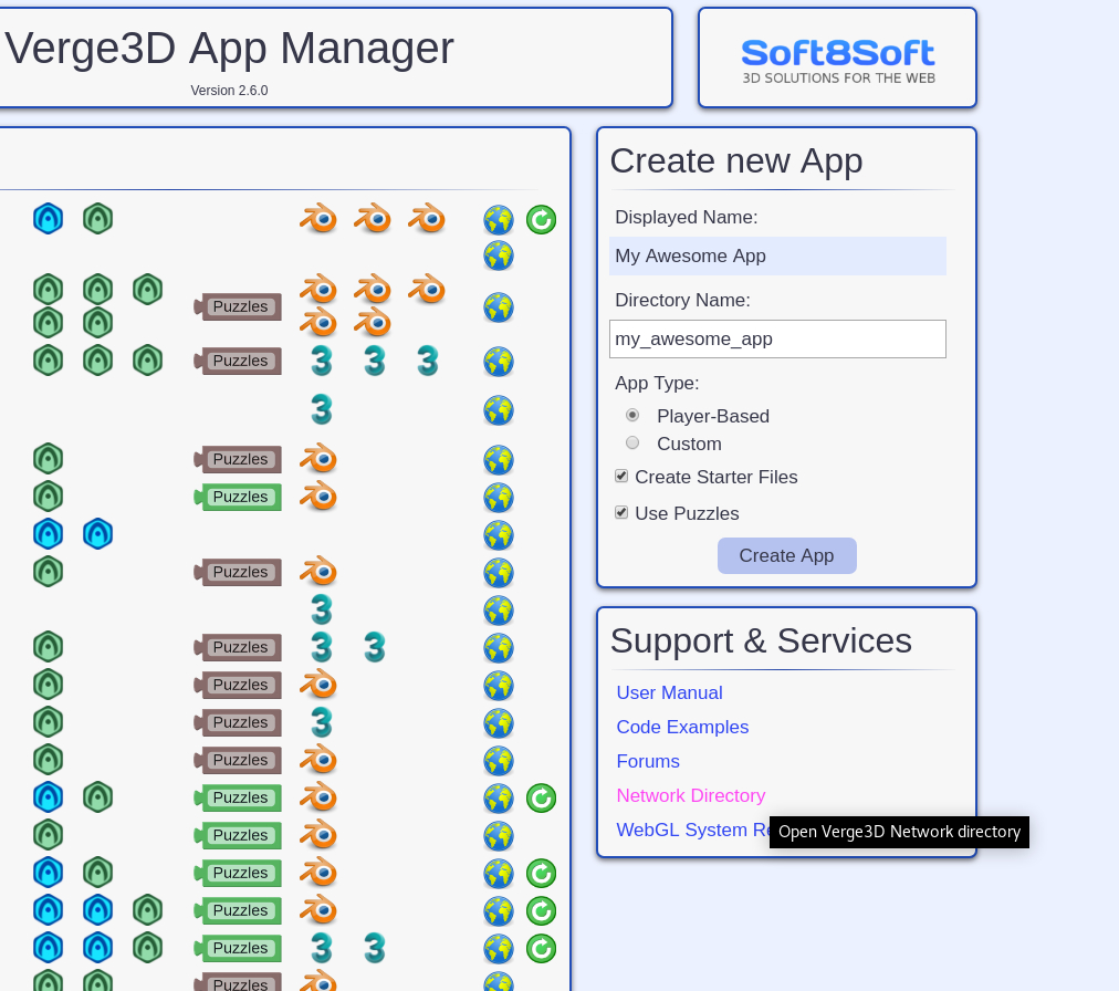

There is a link in the App Manager to access and remove files on the Network Directory.
