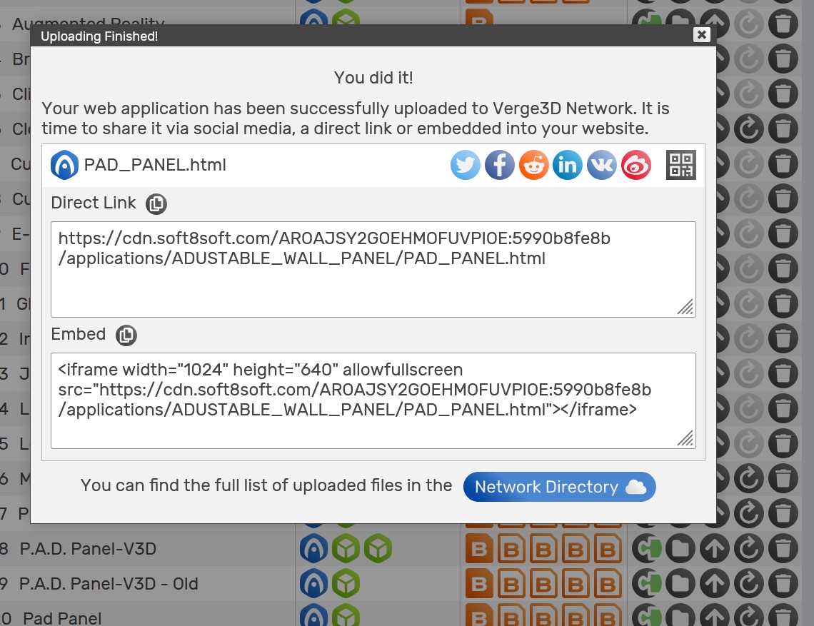

mcolinpCustomerThe page that pops up after I have published a project, which shows web-links as well as social media sharing options, seems to never be something I can regain access to once it is closed. To my knowledge, I am required to re-publish in order to simply get access to the already existing links to the data already hosted on the cdn.soft8soft servers. I know I can open a page that shows which files/projects are hosted on these servers, but unless I am missing something, I cannot access the actual web address that will open these projects on the web.
It would make sense to me, to put a button next to the “Publish” button in the App Manager, that would allow the user to open the window with the links that appears after publishing; instead of having to re=publish every time, (which can be quite time consuming.)

Solution, go to your Cloud icon located on the left side of the App Manager, its the Open Verge3D Network Directory. There you will find a directory structure of the files you have uploaded. Your project(s) folder(s) are located under applications you fill find them by name.
In your case there should be a folder called ADUSTABLE WALL PANEL and within that folder there will be a file called PAD_PANEL.html.
All you have to do is click on that PAD_PANE.html file and the page will load.Quick Tip Suggestion: Book mark the link and place it in your bookmark bar until you are done with the project or at least done with this version of Verge3d. The link for the project will not change as long as you are publishing the same project.
