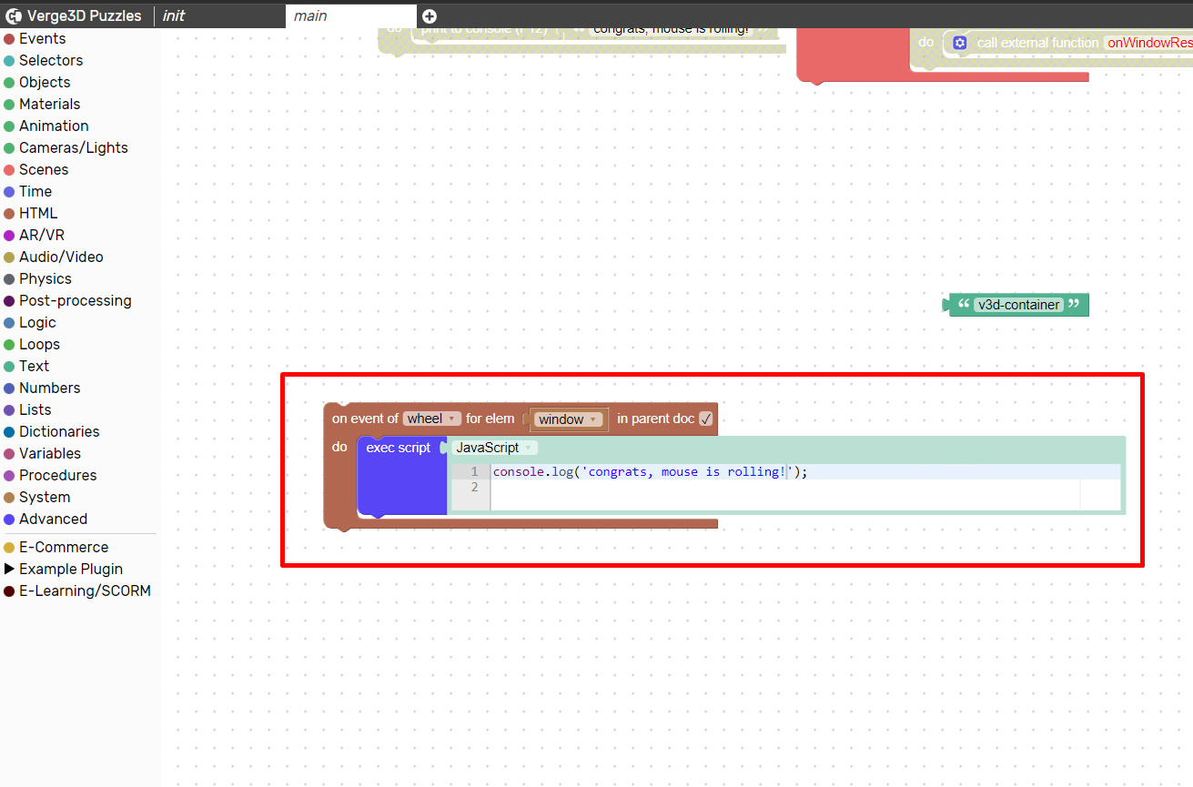

Hi all, i’m trying to recreate this code example
I believe that i did almost understand the behavior itself, now i just look for a way to add it to the existing web app of mine. Right now i faced a problem – i am trying to use html puzzle “on event of wheel” for elem – there i used different options in “for elem” field, such as HTML DOM Object puzzle with all the options – container, window, document, body, or simply put “v3d-container”, both times i tried it with “in parent” checked and without it, but it works only for “My_Custom_UI.html” elements (shown in the attached screen) not for the embeded via <iframe> tag web app itself, there i mean “canvas.v3d-canvas” element, this name i’ve got from inspecting html elements via console inspector
I will later use this “on event of wheel” puzzle to change FOV of the camera, thus enabling zoom into the panorama.
2022-07-03 at 4:02 pm #53834kdv
Participantdisable zooming to free “wheel” event listener
app.controls.enableZoom = false;by default this event listener is busy
in fact, nearly all event listeners are already assinged and busy, but this “wheel” event performs only zooming, not allowing to do something else. for example, it doesn’t allow to scroll pages when the cursor is over

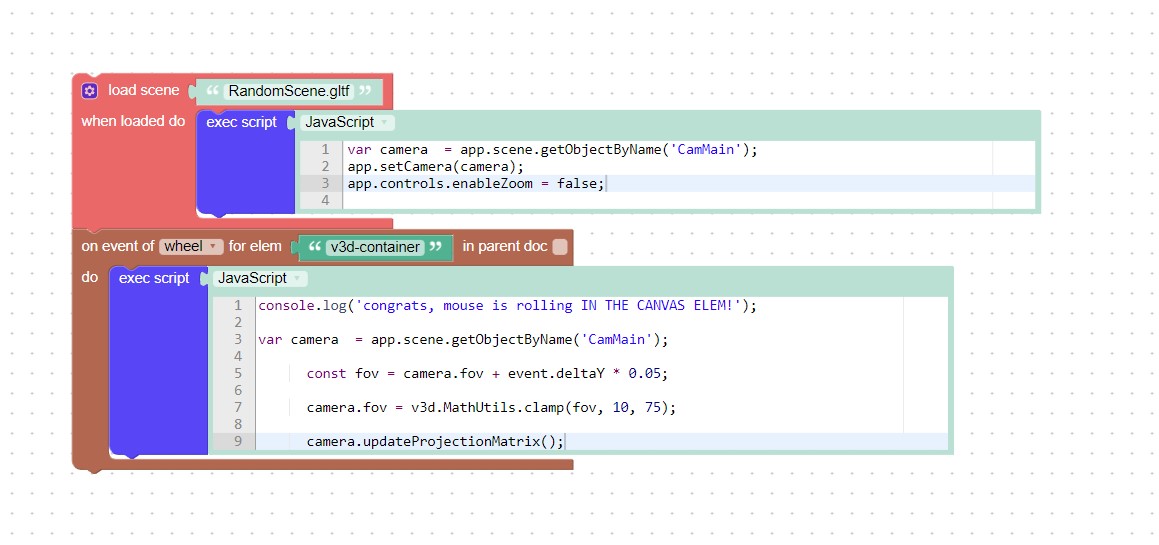

Ilia BgParticipantI mean “var camera = app.scene.getObjectByName(‘CamMain’);
If i don’t do this, then i always get error “camera is not defined” and it works this way with all variables2022-07-04 at 2:11 pm #53846kdv
Participantwhy do you create
var camera? Can’t you useapp.camera?
2022-07-07 at 3:40 pm #53978
Ilia BgParticipantYou right! Big thanks!
