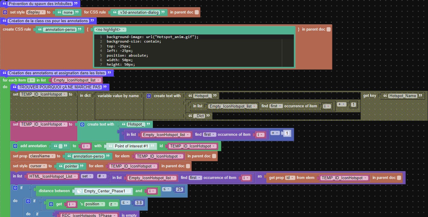

Currently

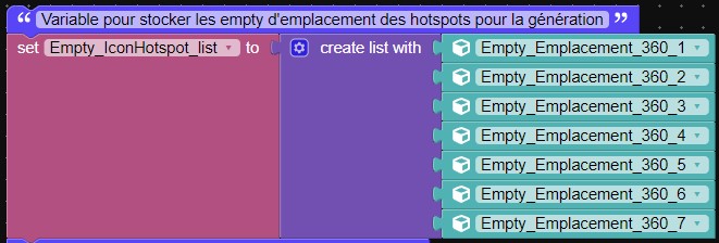

First of all, I create a variable consisting of a list containing all my empties in Blender (manually for the moment, but this will lead to a second question later on).

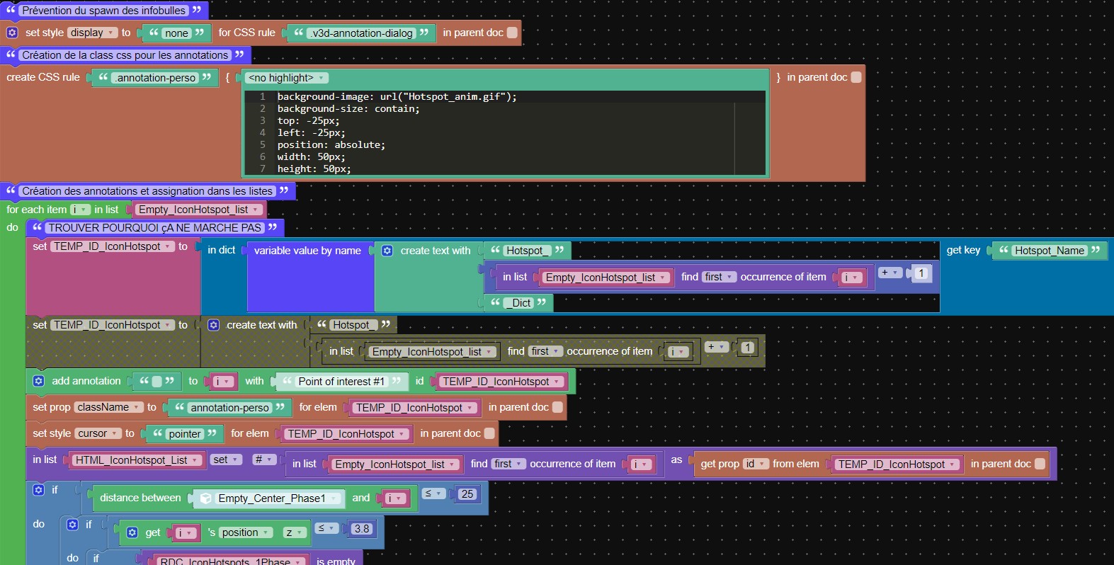

See Attachment 1Then, for each item in that list, I create an annotation by adding a custom CSS Class, and include that annotation in a list for later management.
See Attachment 2So far, it’ s going well.

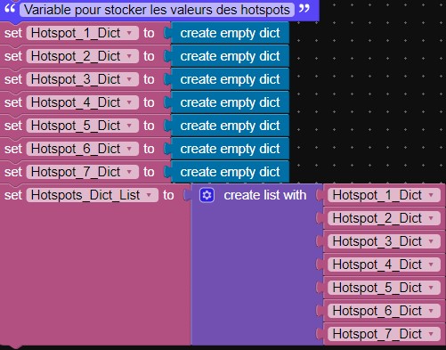

Now
I create variables that are Dicts, and a variable that groups these dicts for debugging.

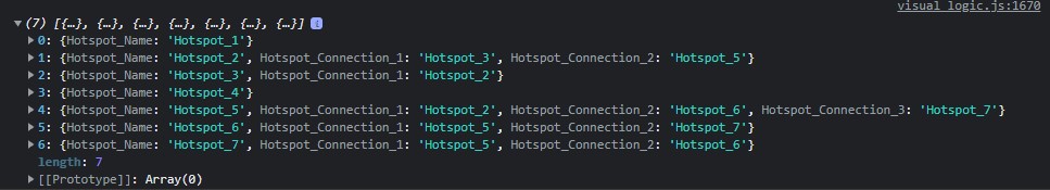

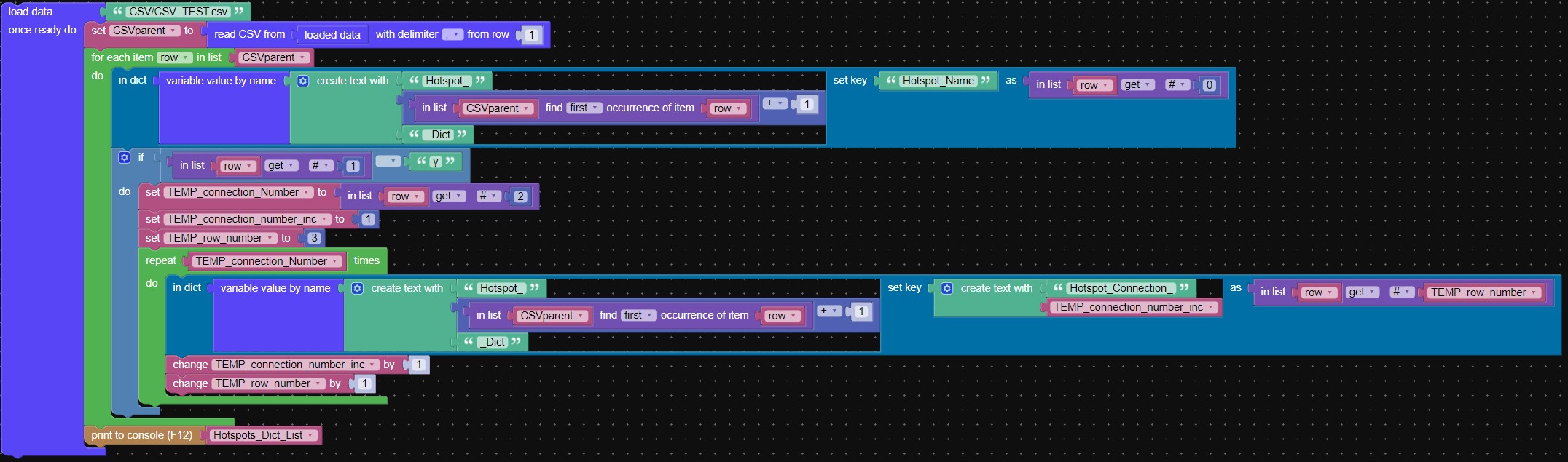

See Attachment 3I add the reading of a CSV file and the assignment of its data in the variables previously created.
See Attachment 4The debug log indicates that the variables are correctly assigned.
See Attachment 5Now I make sure that the annotations ids are managed by a Key present in the previously populated Dict variables.
See Attachment 6The annotations are created but everything related to the id is broken. I assume this is because the creation of the annotations is done at the same time as the loading of the CSV, and thus the Dict variables are not yet filled with the CSV informations.

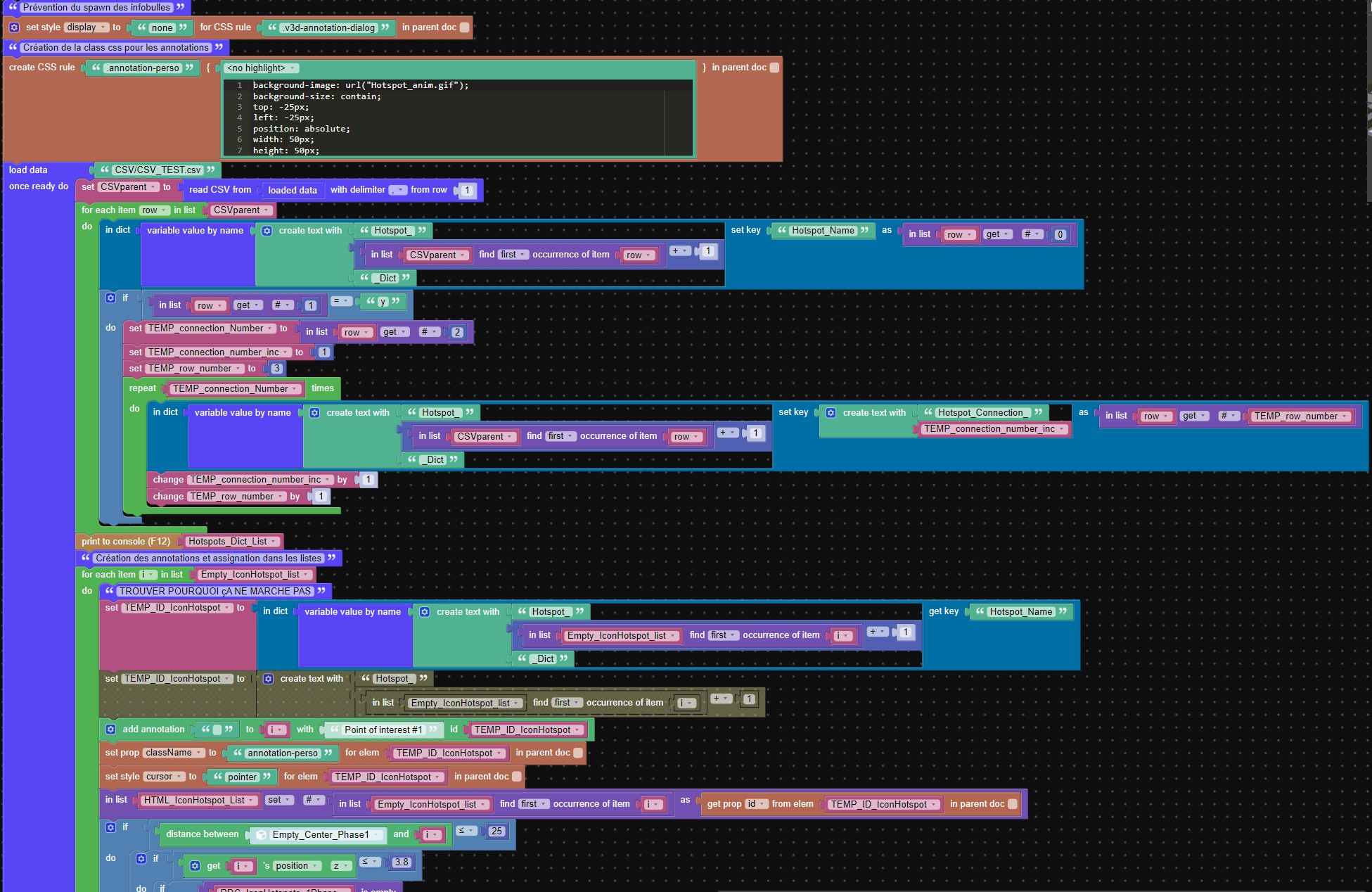

So, I put the whole block of my annotations creation in the “Once ready do” slot of the Load data which manages the CSV loading.
See Attachment 7This ensures that the annotations are generated correctly, with the right Class. But by doing this method, the annotations become not interactable.
No interaction is possible either with an “on event of click” or even with an “on event of mouseover” for debugging.

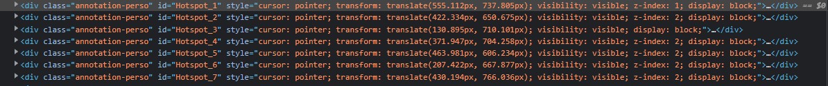

However annotations are present in HTML.
See Attachment 8What is weird is that there are still interactions that are detected because the cursor changes when my mouse passes over an annotation (as specified when generating the annotations with the “set style cursor” block). Also, the z-index changes from 1 to 2 when I click on an annotation, but I guess that’s for the popup display present by default in the annotations system.
