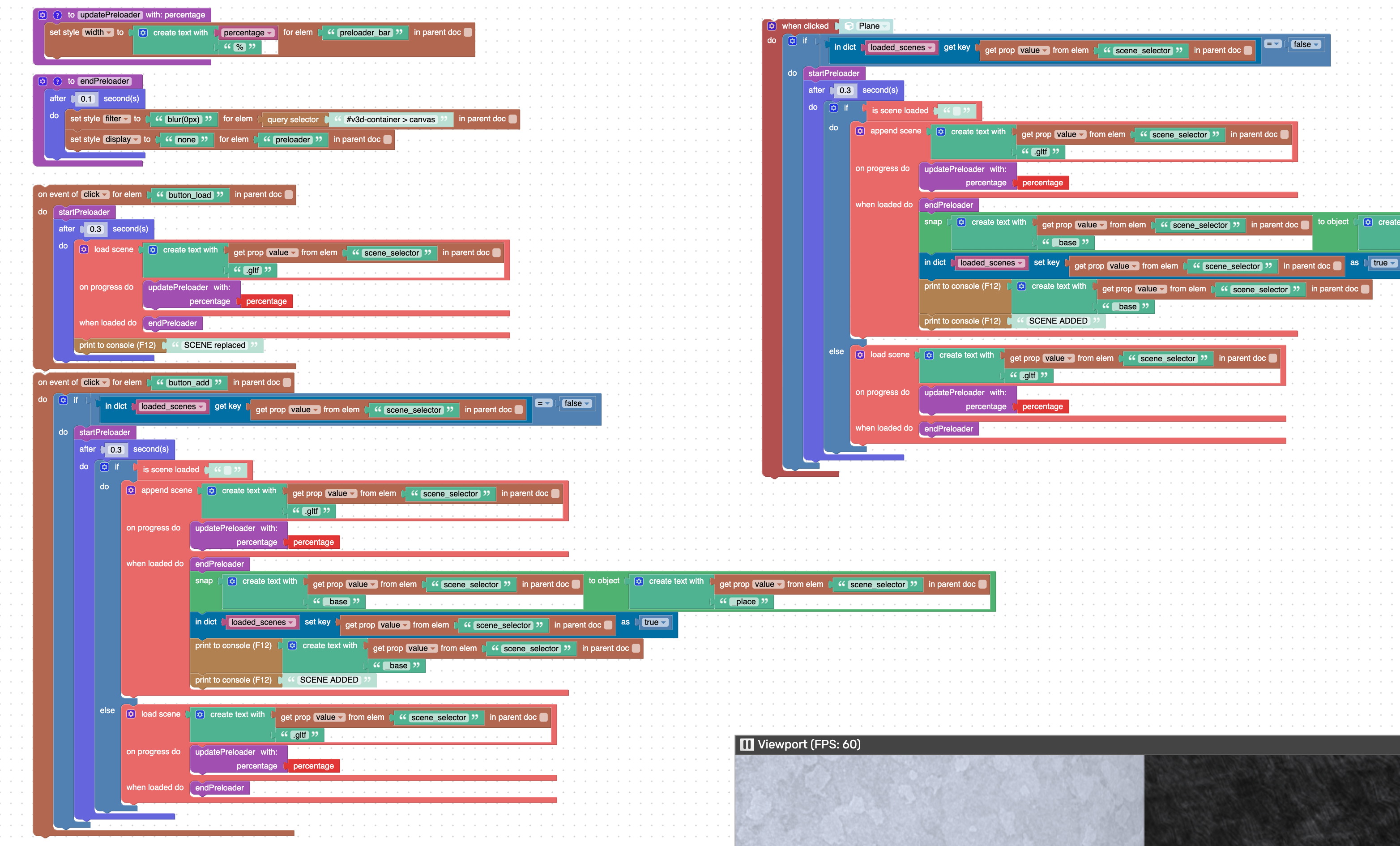

xeonCustomerYou can use clicking on a object vs an HTML/CSS object.
Using the load/unload demo as a sample you can create an object on click event and copy the existing HTML on click event puzzles into it and the object will work…in this example, I used the white wall called “Plane”.
Depending on what you want to use as your animation/transition between scenes…you can do this in 3D as long as those objects are a part of the main scene or you can do it via HTML as this demo does.
If you go this route you would remove many of the HTML brown puzzles with dictionary or lists info to fill out the text instead of reading it in from the HTML window.

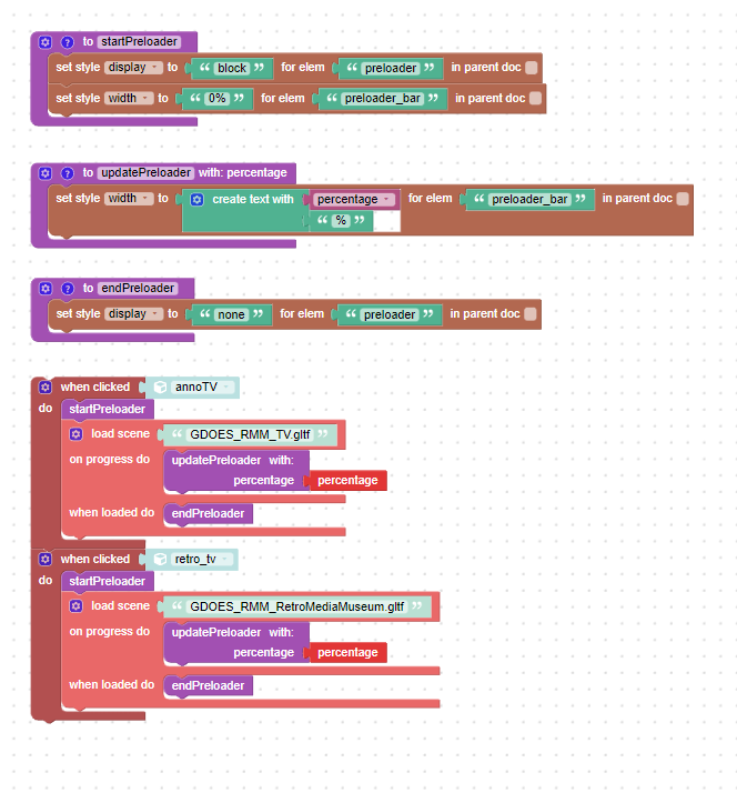

gdoesParticipantOk, I figured out the simplest way.
For now the logic in the screenshot attached gives me a solid static loading-bar (standard loader) in between the loading process.
Am I right if I say, that I could write an HTML element into the source-HTML and assign an ID in the CSS to style the thing?
https://www.gdoesinger.at
Take-Off? Ready when you are!2022-06-03 at 3:46 pm #52656
gdoesParticipantSolved!
So, there were a few wordings unaligned concerning the spelling and I think a puzzle has a wrong spelling (percentage != percantage) but I got so lost in the process I can’t really figure where it went wrong.
After all it was down to a variable not being called with the right name.
Thanks for all your help. The loading bar in between scenes is now showing up.
I get the hang of it.
