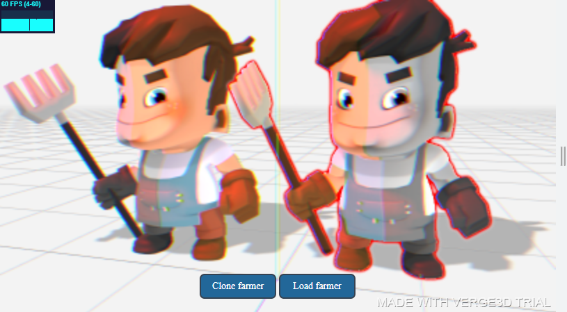

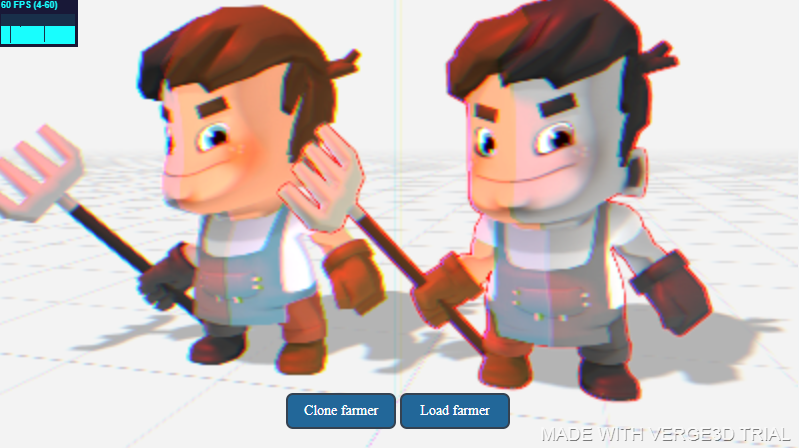

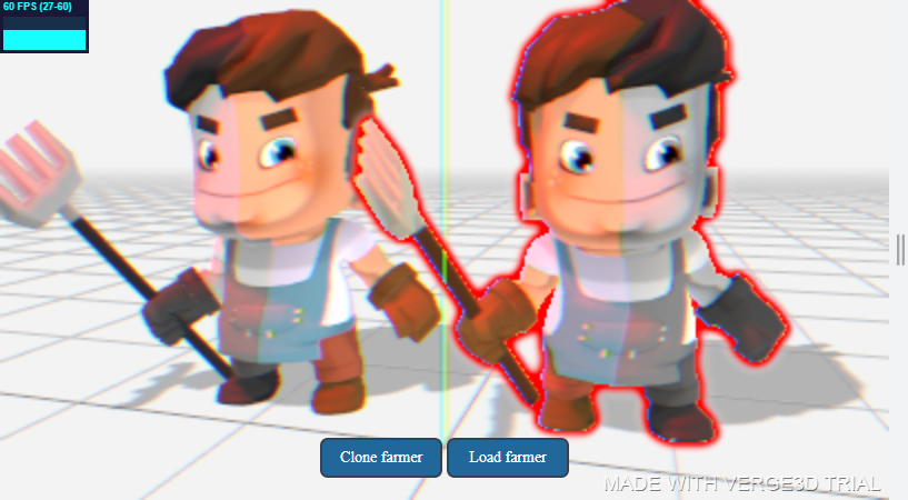

Renderer pixel ratio 0.5, composer pixel ratio 0.5
Renderer pixel ratio 0.5, composer pixel ratio 1
Renderer pixel ratio 0.5, composer pixel ratio 2
The Outline pass definitely works with different resolutions but the overall picture is the same bad.

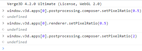

2023-06-21 at 3:52 pm #64755thomasup
Customerthat looks interesting though! seems like you managed to scale them independently.
how did you do the independent scaling?
that would help me out already!2023-06-26 at 7:00 pm #64878kdv
Participanthow did you do the independent scaling?
the same way you did
