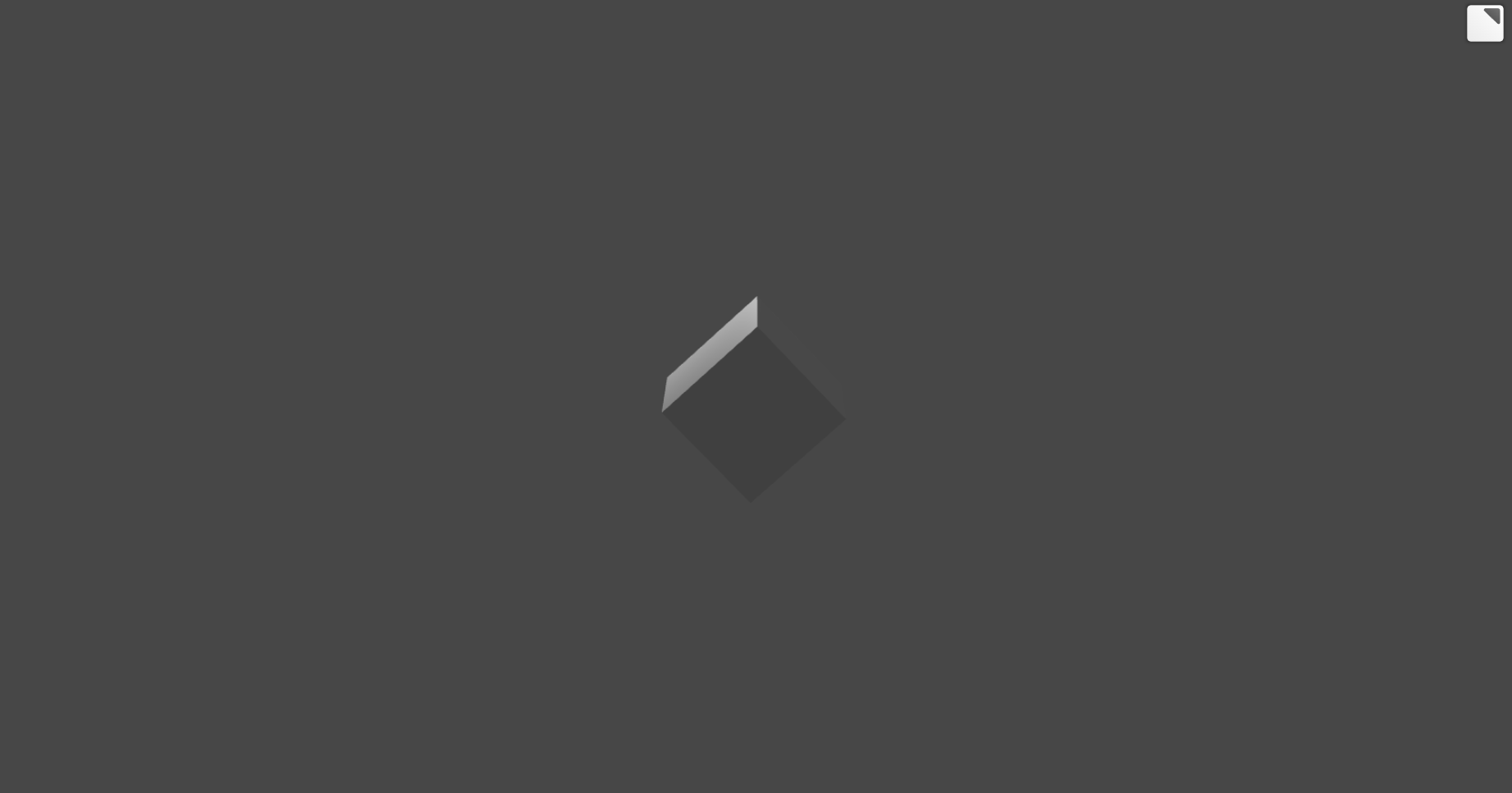

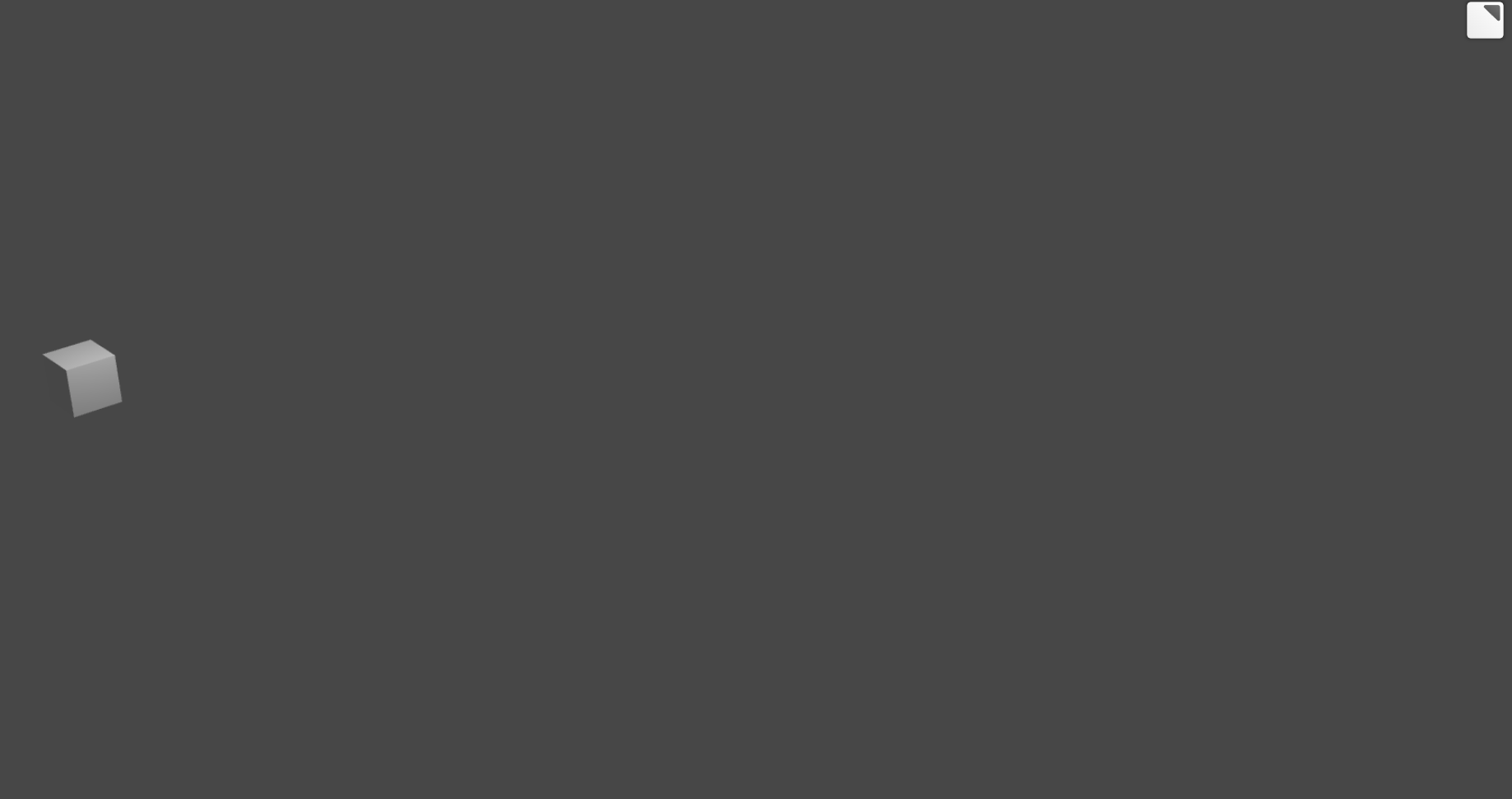

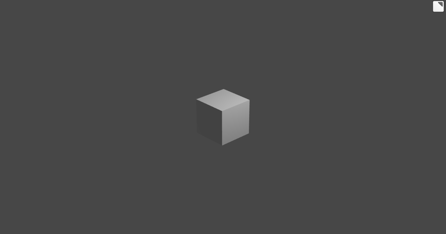

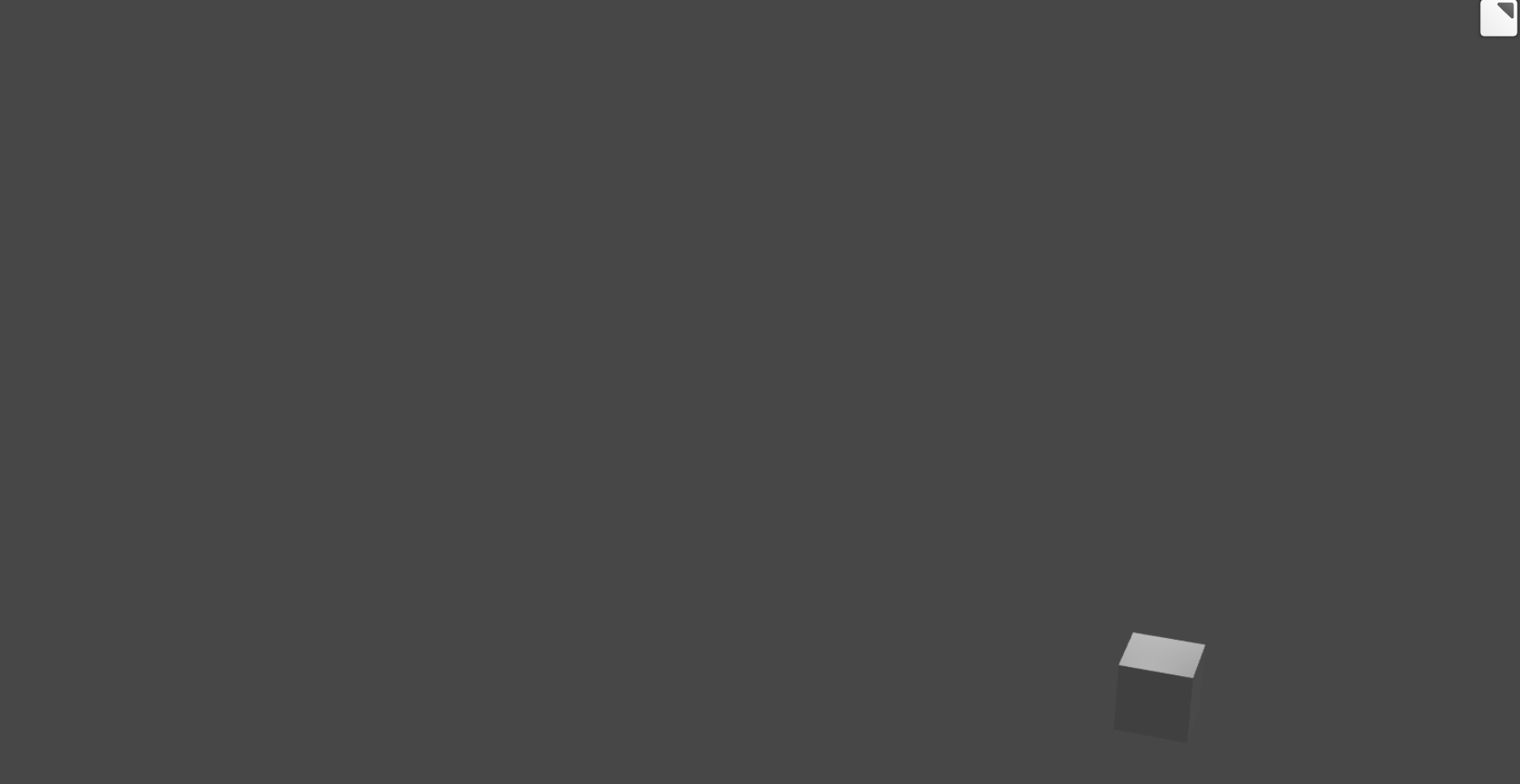

Tutorials - https://www.xeons3dlab.com2022-03-13 at 6:26 pm #50215boka5
ParticipantHello,
yea, but I think versions work just fine. I don’t have problems like synchronization in between them.
It works just the same as if we would just create a new project with the default cube in the center in a blender and then use Sneak Peek to try to rotate it. I will share a few screenshots to show it.
It is totally the same with my project, just imagine if I would like to move the cube some corner and then rotate it to fit in with the background.From the first two screenshots, you can see that cube rotates around itself. But when I move it left and then rotate it with the left click, it rotates around the center of “display”, like doing circles.

xeonCustomerOk I think I know what you are since you are having this problem with a default cube and default camera.
Please note, that when you send your scene to sneak peak you are not rotating the cube. You are rotating the camera.
Next when you think you are moving the cube…you are actually moving the camera target. This is causing the offset you are seeing. The cube hasn’t moved…just where the camera is looking.
If you want to rotate the cube, you will need to open the App Manager and then create the necessary puzzles to rotate the cube or keyframe it in Blender and use the play animation puzzle.
