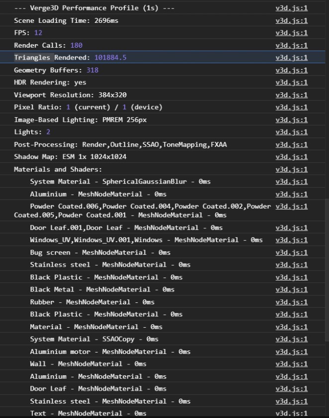

    We have a problem in performance, our app is running at 9 fps at some moments.
    I read the docs but couldn’t identify exact problem in screenshot provided bellow, to be able to tell our 3d artist what could possibly cause the problem.
    I think the problem is: too much render calls and too much triangles.
    If those are the problems, I would like to know what to tell to our 3d artist, what to fix and how. I found just basic info out there…
    If someone can help me to identify crucial bottlenecks that would be awesome.
    #36291
    Thanks for sending us your performance profile. I’d say the most performance-hungry things in your scene are postprocessing (especially SSAO) and the amount of draw calls (180 is really high). Try to disable SSAO and reduce the number of rendered objects in your scene (to do so, join your objects together to form a larger batches).

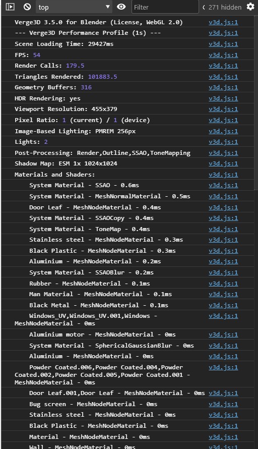

    Hi Alexander,
    I noticed this happens only on chrome ( even incognito mode ).
    I performed same thing in edge chromium and it has almost identical numbers but fps is 54.
