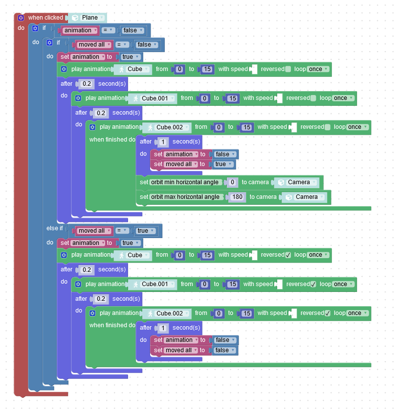

    so I’m trying to create a limiter on the horizontal rotation.
    Basically, the Verge-settings in Blender give me unlimited horizontal camera rotation around my object. However I want it to be limited to 180° once a new object slides into the scene.
    While this is a simple Event-setup – after the lock has been activated, the camera snaps to different perspectives/angles when zooming in or out. It’s a very basic setup with an if-Event and then “set orbit max horizontal angle” to 180° and the “min angle” to 0°.
    Also when I set the “set orbit max horizontal angle” to infinity, the snapping keeps happening.
    There is no snapping in the base file without any puzzles.
    I hope the question is understandable.

    Not sure how to implement the puzzle though so I screenshotted it.
    Hope this works.
    After clicking on the plane, the three cubes move and the horizontal rotation is locked to 180°. When you zoom in or out the Cam snaps to different angles.

    After pressing on the plane, the cubes move forward and the camera movement is limited to 180° horizontally. While that works fine, when you try zooming after the limit, the camera view jumps to different perspectives.
