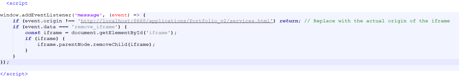

    The line of code in the attachment isnt closed right? It’s code that i don’t use anymore, but even with this error removed and the html line added the problem still persists. I can honestly live with this error tho. If i want to work on my puzzles i just remove the –
    <link rel=”stylesheet” type=”text/css” href=”css/webflow-style.css”>
    – from my code to view them, it is what it is.
    From the bottem of my heart thank you for helping me this far, i would of never be able to figure it out without you :heart:
    #71710
    Yeap. You have there <script instead of <script>. The very first line on the scrinshot.

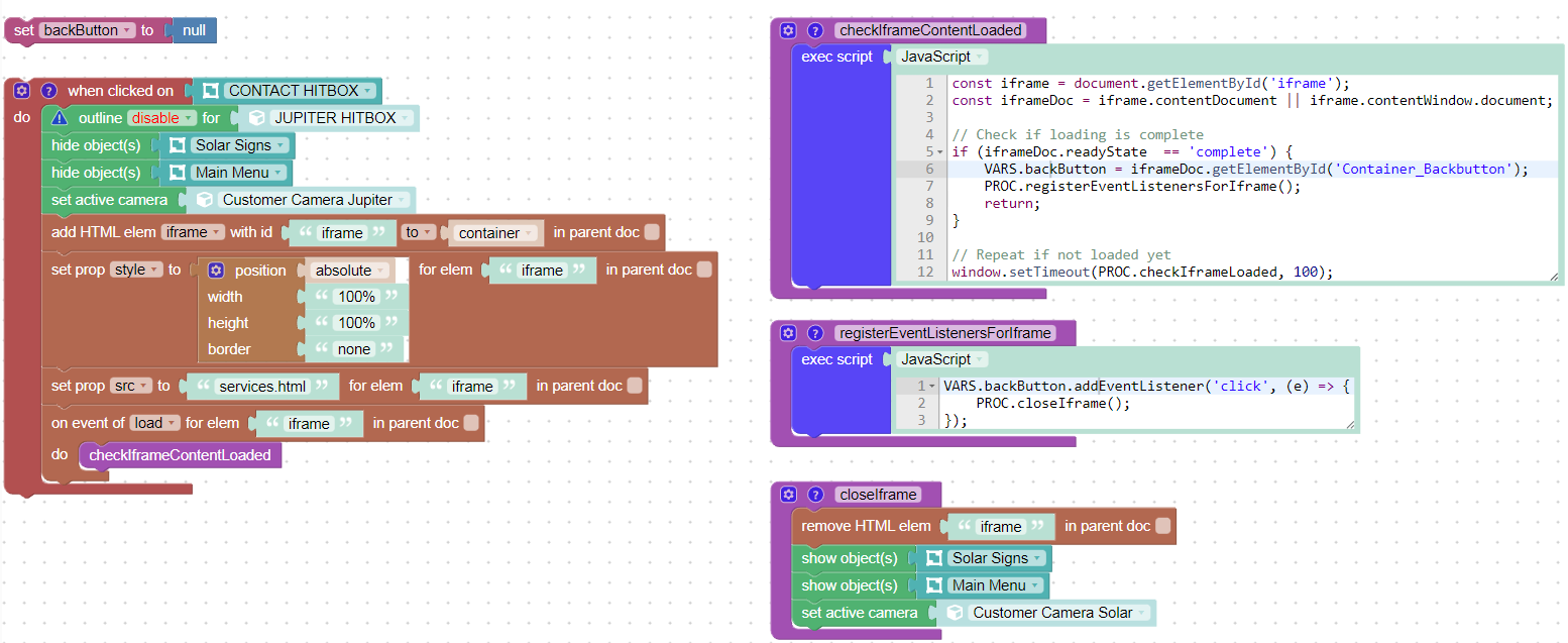

    You can add an event listener to any element in a dynamically loaded iframe this way. It’s not possible with puzzles but is quite easy with JS code.
    https://v3d.net/u5k
    The point is that you can add event listeners inside an iframe only after its content has been loaded, not earlier.
