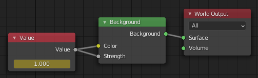

bigcatrikParticipantWhen attaching an animated Value node to the background node inputs in a world shader the animation does not work in Sneak Peek or a gltf export.
It works in Blender (in Rendered viewport shading mode) and those inputs are supported by Verge3D as per the manual (https://www.soft8soft.com/docs/manual/en/blender/Shader-Nodes-Reference.html#Background).
Attaching a value node and animating it works on other texture nodes, why not these? Bug, or WebGL limitation?
A very simple example is attached. Select Rendered viewport shading mode once loaded and press play (spacebar, the cube is blue). Then try it in Sneak Peek. Not the same.
In this file the animated Value node is attached to both the Color and Strength inputs. Either one on their own, or both, will work in Blender, but no combination works in gltf.

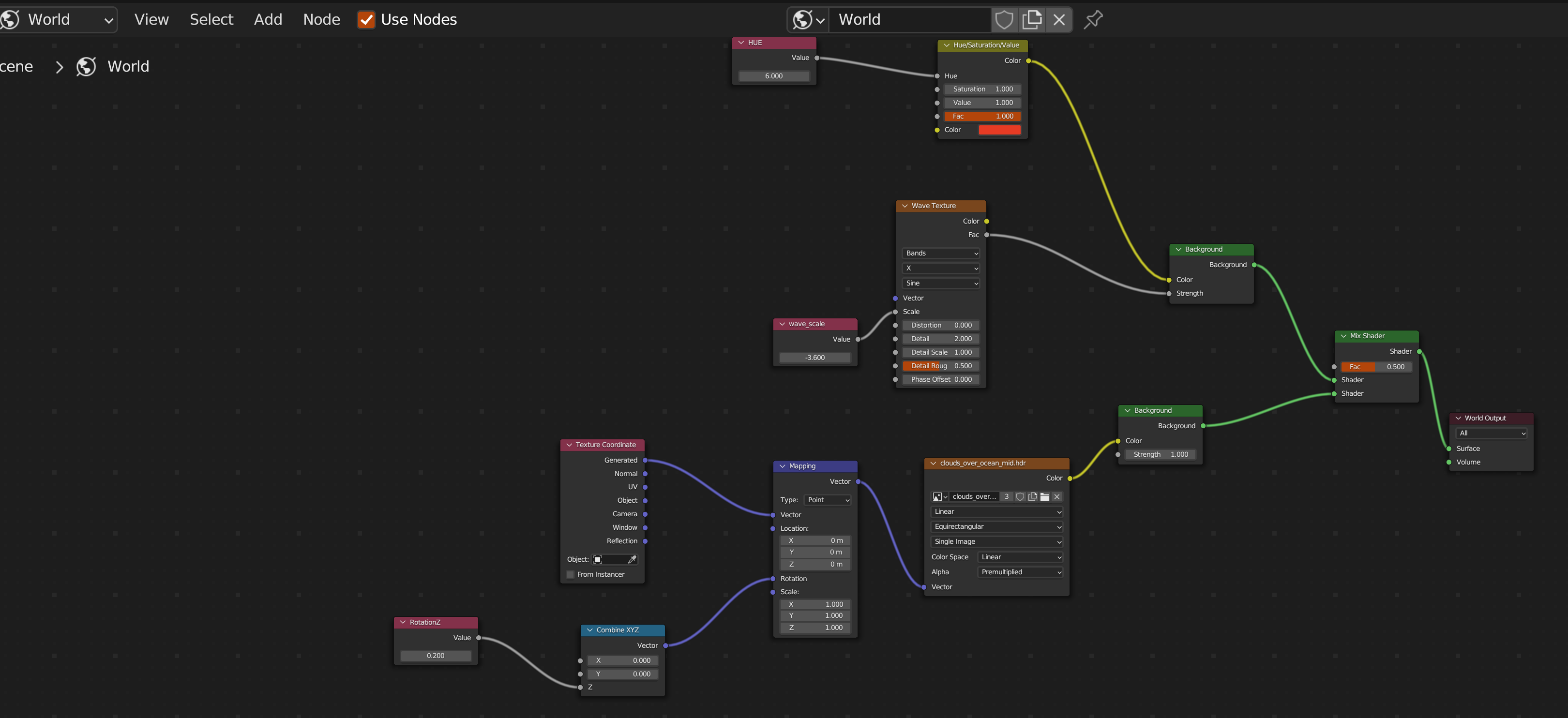

In the sample Blend file you provided you connected a value node directly to the input of color and strength. The problem with the setup is that the color input of the background node is expecting an RGB value. You could add a Combine XYZ node between your value and the color input and use the value then to drive the background color, but a direct value input is not the correct input for what you are trying to do.

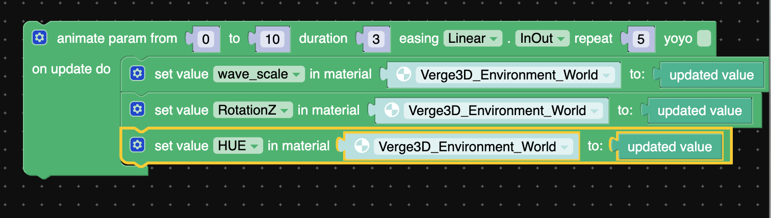

But on to the good news. Attached are two images. The first is a World Environment shader that uses Value nodes to control rotation, color(HUE), and a wave pattern I put in just for kicks.
The second image is a puzzle set that will allow you to animate these values or in this case will automatically animate them. You can try this in sneak peak or export as a GLTF and try in your own application and you will find you can control and animate just about every parameter that you have control over with a normal material shader.
So yes… animate away.

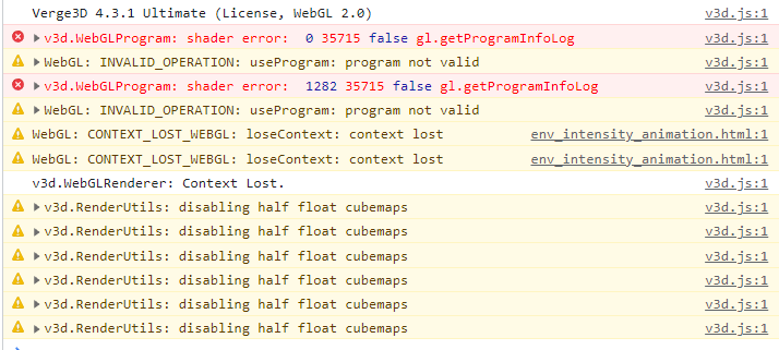

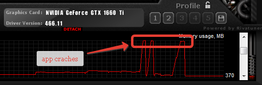

Tutorials - https://www.xeons3dlab.com2023-07-27 at 11:10 am #65634kdv
ParticipantOnce again: trying to animate the world shader will force an app to die in several seconds (when video memory is overloaded. time directly depends on the amount of available video memory). Updating the world material is a very expensive process.

Tutorials - https://www.xeons3dlab.com2023-07-27 at 5:18 pm #65644kdv
ParticipantJust a simple test: share that app. And test it on your phone…
How large of a texture did you use? I used a 2K HDR texture
512×256
