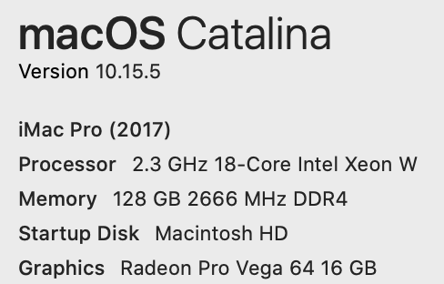

    I purchased Verge 3D because a client needs me to export my Maya MB file to GlTF for use at another vendor that specializes in building files for UX kiosk display.
    The file I need to export is approximately 108mb. It has a number of animated objects as well as a few displacement and bump maps.
    When I trey to use Sneak Peek, the export stalls at between 10-20%. A reboot of the program is usually required as hitting the esc key has no effect.
    If I try to export geometry using “Export Selected” with GlTF selected as the file format, the MEL line states the export was successful, but no file can be found at the target directory.
    Any help would be appreciated.
