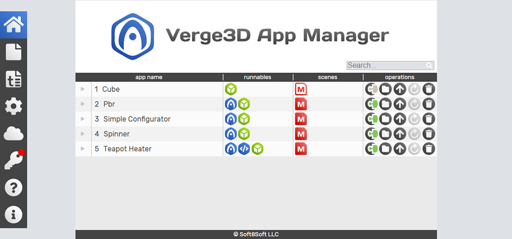

The App Manager opens up in the web browser when you select the Run App Manager option in the Verge3D menu (or click the corresponding shelf button).

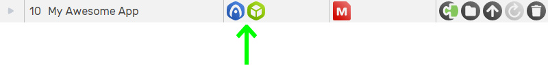

You can run your app any time by clicking the Verge3D icons, either the blue or the green one. The blue icon launches an app in its final form, with its Puzzles scenario and the programming code (if present). On the contrary, the green icon only opens the exported scene.
Buttons to run My Awesome App

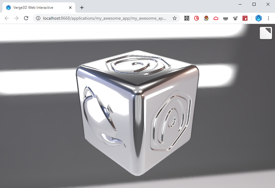

A freshly created app loads and displays just a cube. You can look around with the left mouse button pressed, and zoom in and out with the mouse wheel.
Running My Awesome App in the browser

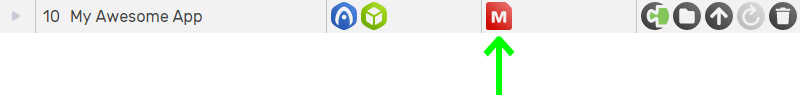

By clicking on the M icon you can open up the main .ma/.mb file of your application.
Button to open Maya scene of My Awesome App
The save files can also be opened as usual via the FileOpen dialog or simply by double-clicking on them in the application folder. FileOpen may sometimes be more efficient since it does not spawn a new instance of Maya.

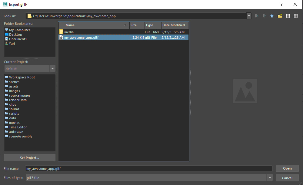

Export your scene to the root of the corresponding application folder, in glTF format.
Selecting name for exported glTF asset

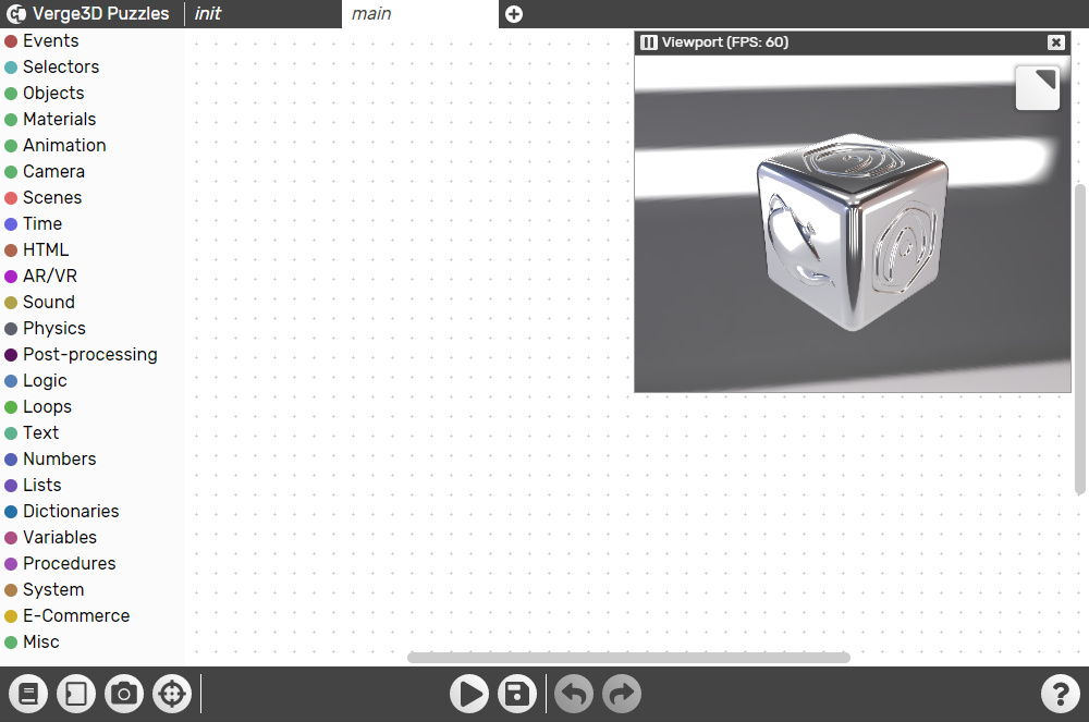

Click the Puzzles button near your app name in the App Manager. This will run your app with the Puzzles editor attached on top of it.
Puzzles editor screen
On the left the toolbox with some categories ("Events", "Selectors", "Objects", etc) is located. The categories are expanded upon mouse click revealing puzzles which you can drag out to the workspace. By connecting various puzzles with each other, you can create a scenario of how your 3D objects will behave upon user input.
You can quickly obtain help for any puzzle by hovering the mouse cursor over it or by using the right-click menu.
Puzzles toolbox

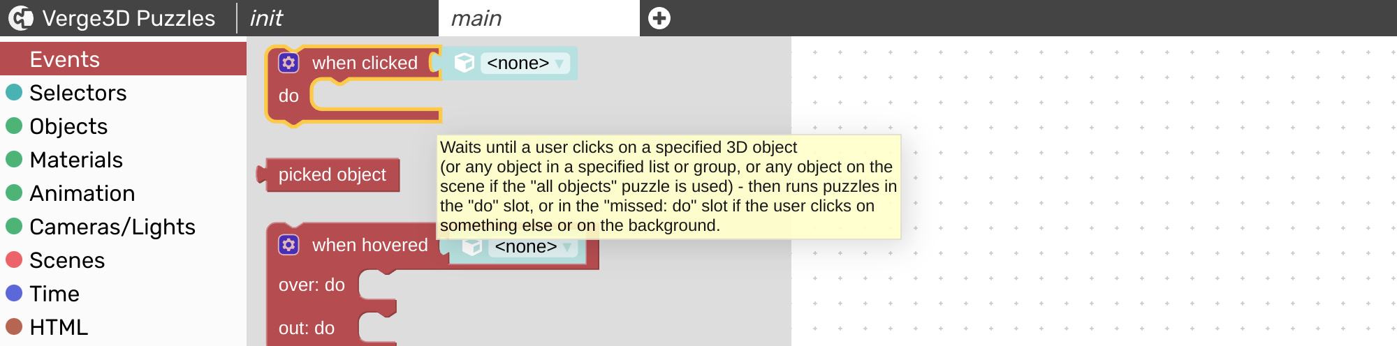

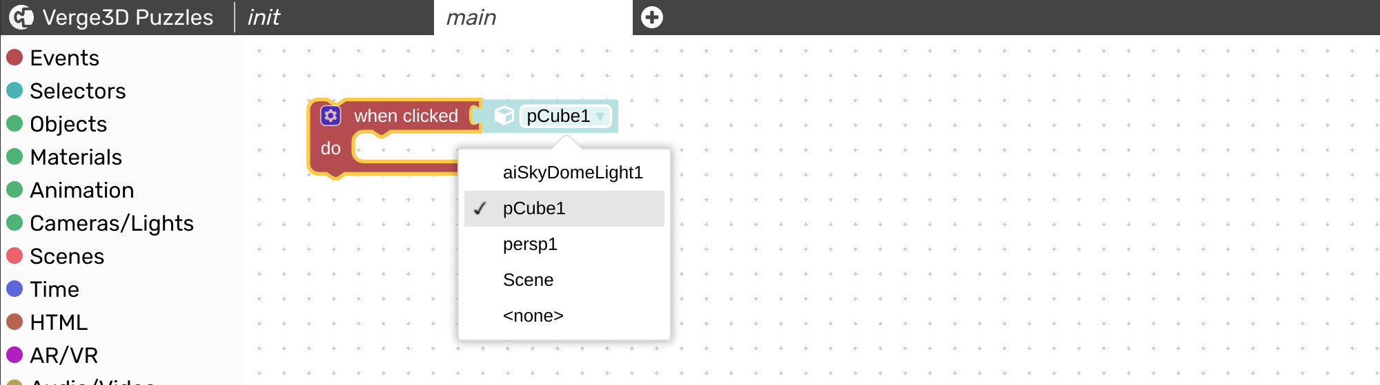

To do something meaningful for the beginning, drag out the when clicked puzzle from the Events category and select some object in the light-green dropdown.
Adding when clicked puzzle block from the toolbox
This puzzle causes your app to wait until the user clicks on the specified object, and then do... nothing unless you add something in the do slot.

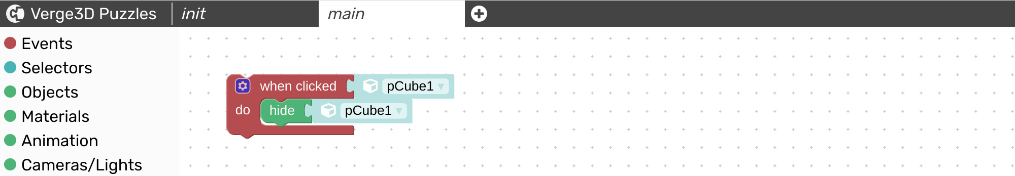

Drag out the hide puzzle from the Objects and insert it to that slot. Select the same object ("pCube1") in its dropdown.
when clicked and hide puzzle blocks in action

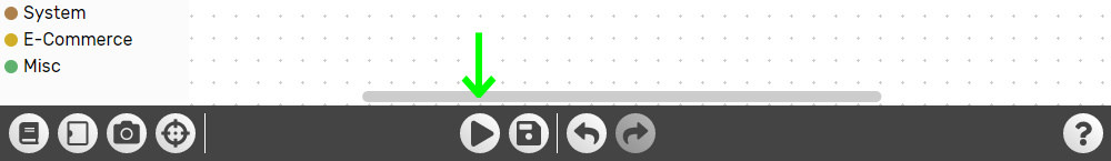

Now, once the user clicks on the 3D object, it should disappear. Click the Run button in order to launch your program and check if it works by clicking on the cube.
Button to run puzzles

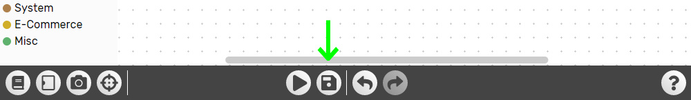

In order to make your scenario a persistent part of your application, be sure to save it.
Button to save puzzles
Once you have finished with Puzzles, you can run your now-interactive app using the blue icon in the App Manager.

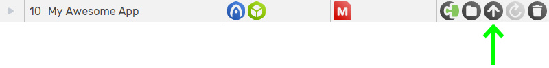

But what if you haven't had the chance to become a web master? No problem - by clicking a button in the App Manager you can upload your app to the Verge3D Network, a cloud-based storage and CDN hosted on Amazon servers.
Button to upload My Awesome App to Verge3D Network

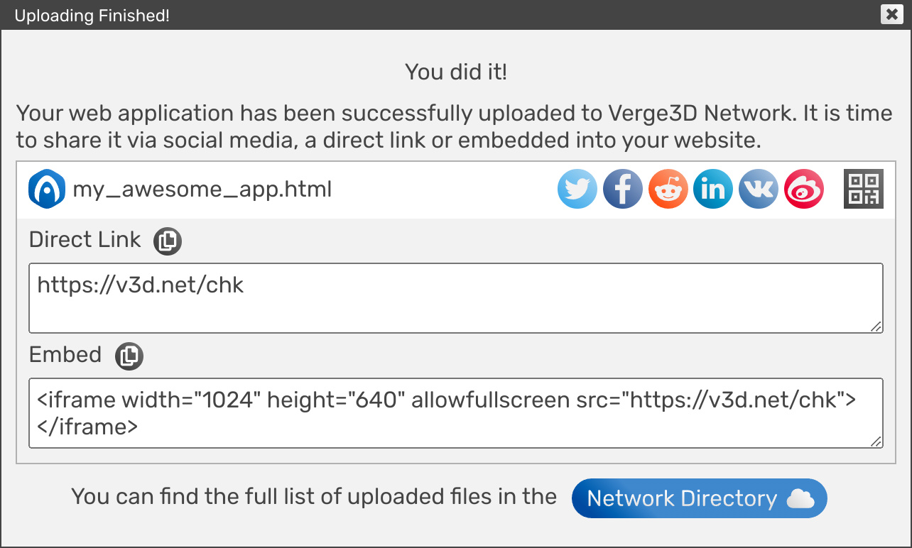

After the uploading is complete, a screen will show up with a direct link which you can share by whatever means (in a blog post, social media, comments, email, you name it). It will also generate HTML code for embedding your app in third-party websites just like you do it with YouTube videos.
Dialog to share a link to My Awesome App

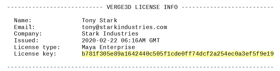

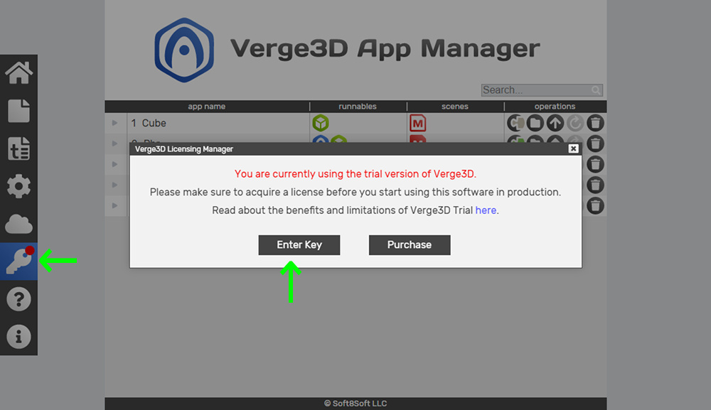

You can take the trial for a spin for an indefinitely long period of time. However, for use in production you will need a license. The license information is sent via email (the key below is a random example).
E-mail with Verge3D license key Activating Verge3D for Maya license

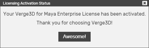

The license key will activate your Verge3D instance and will remove the trial watermark from all your apps.
License activation status dialog
