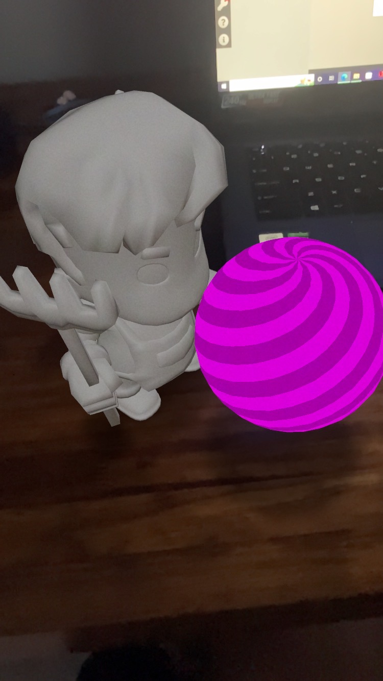

3- Using the piece of the puzzle you shared in the previous response, I could access the AR with my iPhone, but I could NOT see the colors of the farmer (see attached pic). Any hints?

So getting a Gray model means when the USDZ was created the materials were not encapsulated in the output. USDZ files contain all the animations, and textures in one file. You will need to try re-exporting the file making sure that your export options have your required outputs selected. If that does not work try a different USDZ exporter.
Note there are two GLTFs exports in Blender, one is for Verge3d and the other is more generic. You will want to export using the Generic GLTF which will create a .glb file. This file can then be converted to USDZ using a wide range of online tools. Blenders plugin for USDZ does not work properly. My suggestion is since this is Mac specific, best to do these things on a Mac or iPad using xCode or AR tools.

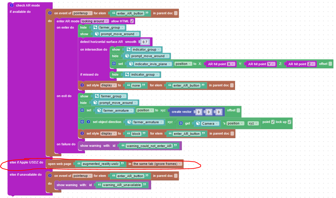

4 – In the puzzle, I renamed the farmer.usdz into augmented_reality.usdz because that is how I named the file in the folder (see puzzle1.png attached). I also added the web page puzzle (see puzzle2.png attached), but I could not see any change.
