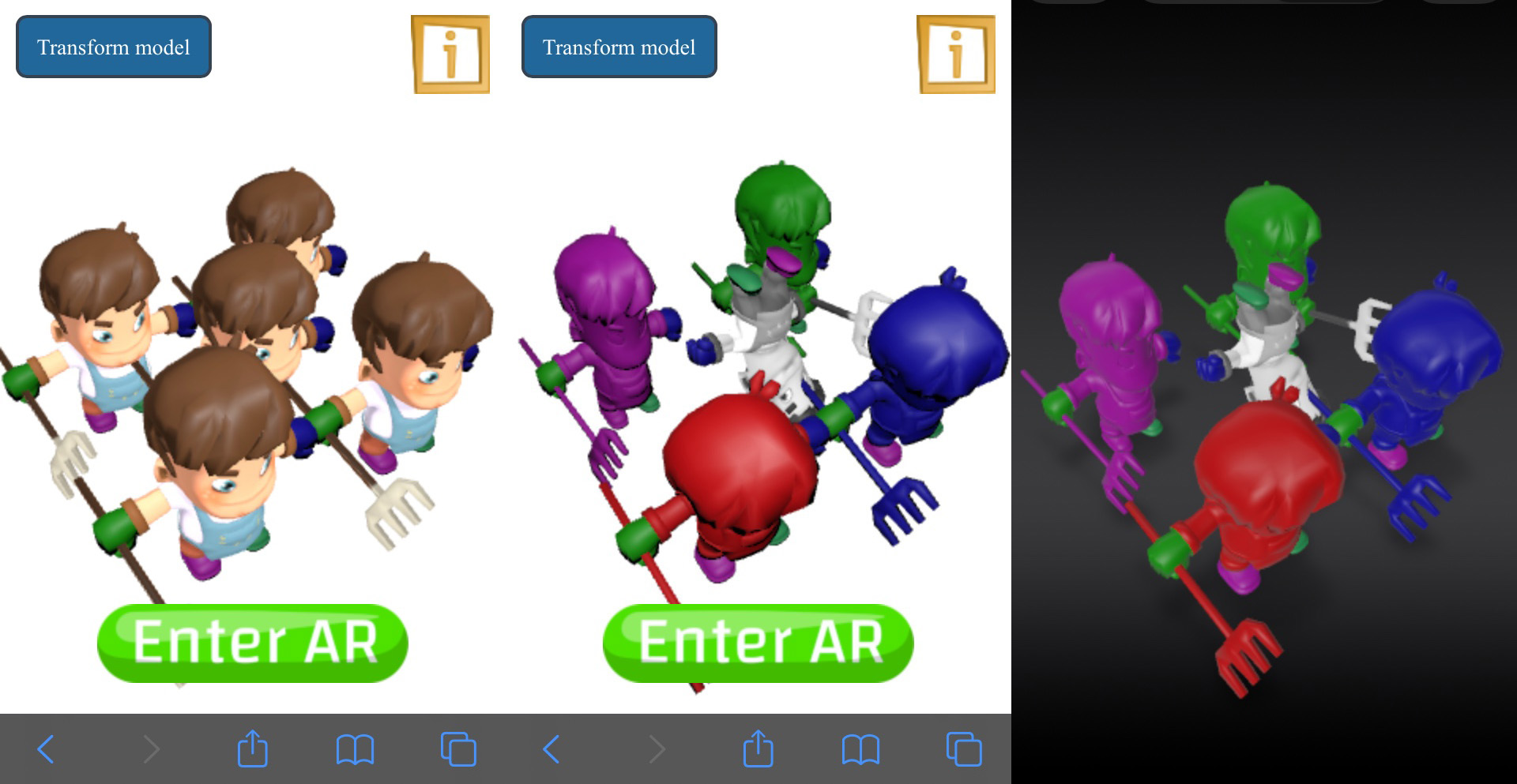

ParticipantI’ve just made a simple V3D plugin for iOS devices that allows to export your 3D models with transformations and changes of materials/textutes. Shape keys are also supported. Animations are not supported (the current V3D engine doesn’t export them).
You can test it here. Use iOS Safari.
https://v3d.net/9e4Get this plugin on Gumroad https://kdv77kdv.gumroad.com/l/ar_for_ios

2022-07-19 at 9:24 pm #54245kdv
ParticipantAdded shape keys support
As I said, morphing was completely ignored. Only one shape keys pair supported at this moment (Base and Key 1, for example).You can test it here. Use iOS Safari.
https://v3d.net/9e4The plugin was not changed yet. All changes were made in V3D USDZExporter…
2022-07-21 at 4:42 am #54264kdv
ParticipantAdded full support of multiple shape keys. The combination
positioning + scaling + rotating + morphingworks perfect )))There is one limitation: in Blender shape keys can be relative to any other key, not only to Base, but Verge3D ignores this fact and all shape keys are relative to Base key only. It’s not a problem, just to be informed…

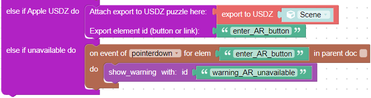

ParticipantIs there a way to add ‘#allowsContentScaling=0’? By adjusting something in the plugin or by adding puzzles.
I’ve attached an image of how I did this before I was using your plugin.
2022-09-08 at 3:04 pm #55670kdv
ParticipantIf you don’t need shape keys then just put these puzzles inside
on event of clickpuzzle and it will work. For now my plugin doesn’t allow adding options to the download path…Puzzles and JS coding. Fast and expensive.
