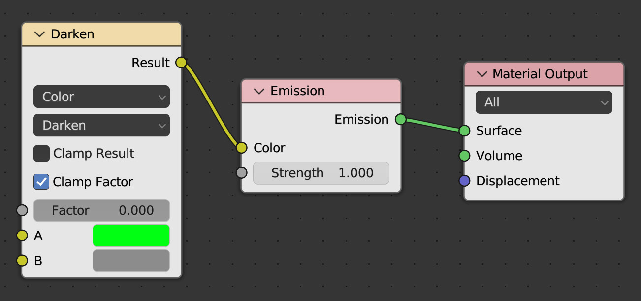

    This material setup in Blender exports wrongly, it turns out to be absolute black instead of green color. Mix Fac is 0.

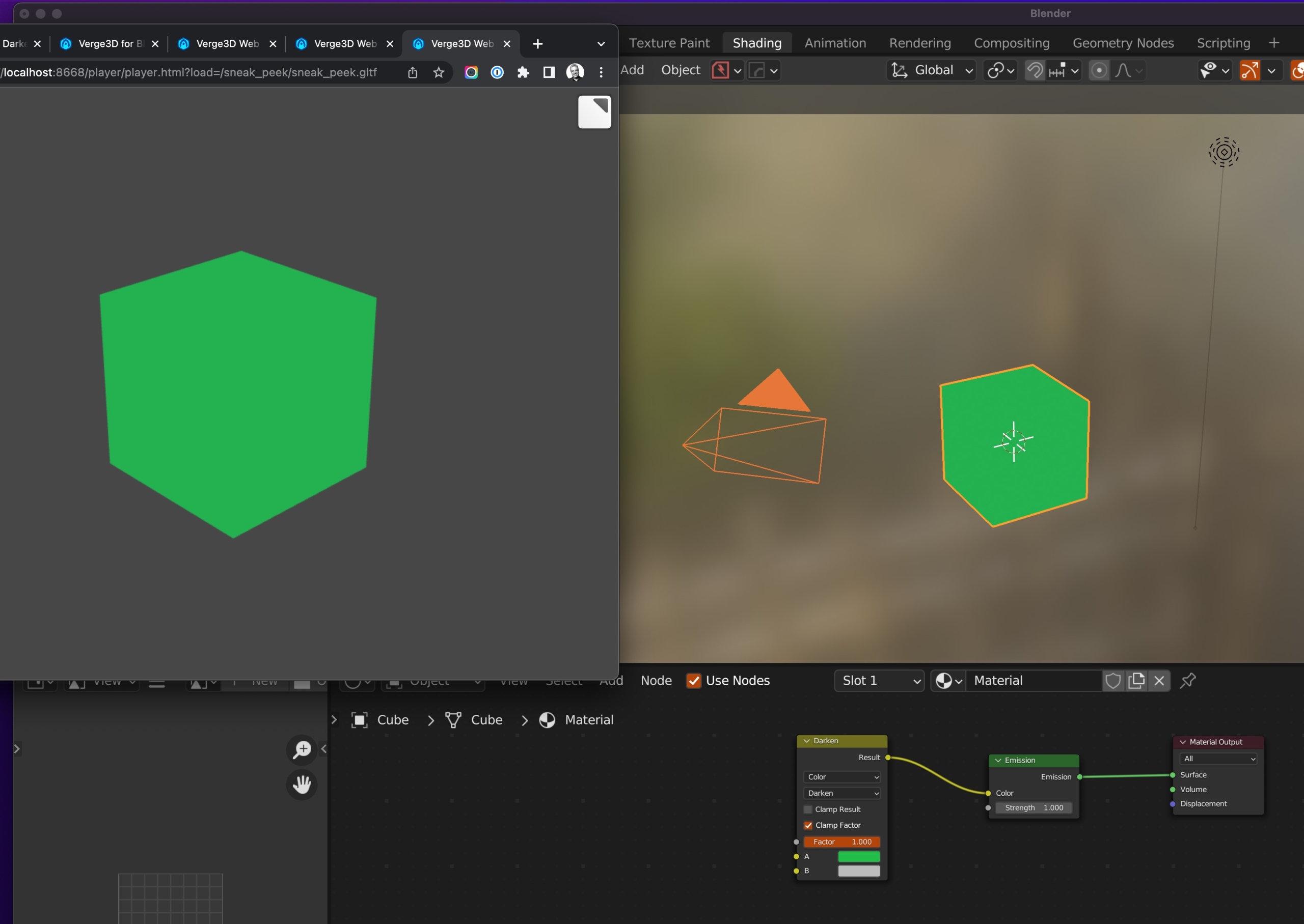

    What version of Blender and v3d are you using? Just tested in B3D 3.5.1 and V3D 4.3.1 and its working nicely.
    #65198
    In your case Mix Fac is 1 instead of 0.

    Black. As I see, the result in Verge3D is invereted. The more factor the greener the cube becomes. You can use Multiply or Overlay instead to get the result close and similar to what you see in Blender.
