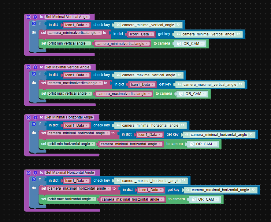

    Hello, i have a question about setting for horizontal and vertical min and max angles. I have json file in my folder in which iam setting values and for vertical angles it work like it should but for some reason it wont work for horizontal angles.
    Theres a screenshot of my puzzles for this in attachment.
    Besides this i made a call for those procedures. Is there something i did wrong or?

    Hi, it seems that the screenshots didn’t get attached. Can you post them again?

    I couldn’t reproduce this issue and I also don’t see anything wrong with your puzzles. Can you provide a link to the app or to a simple example to reproduce it?

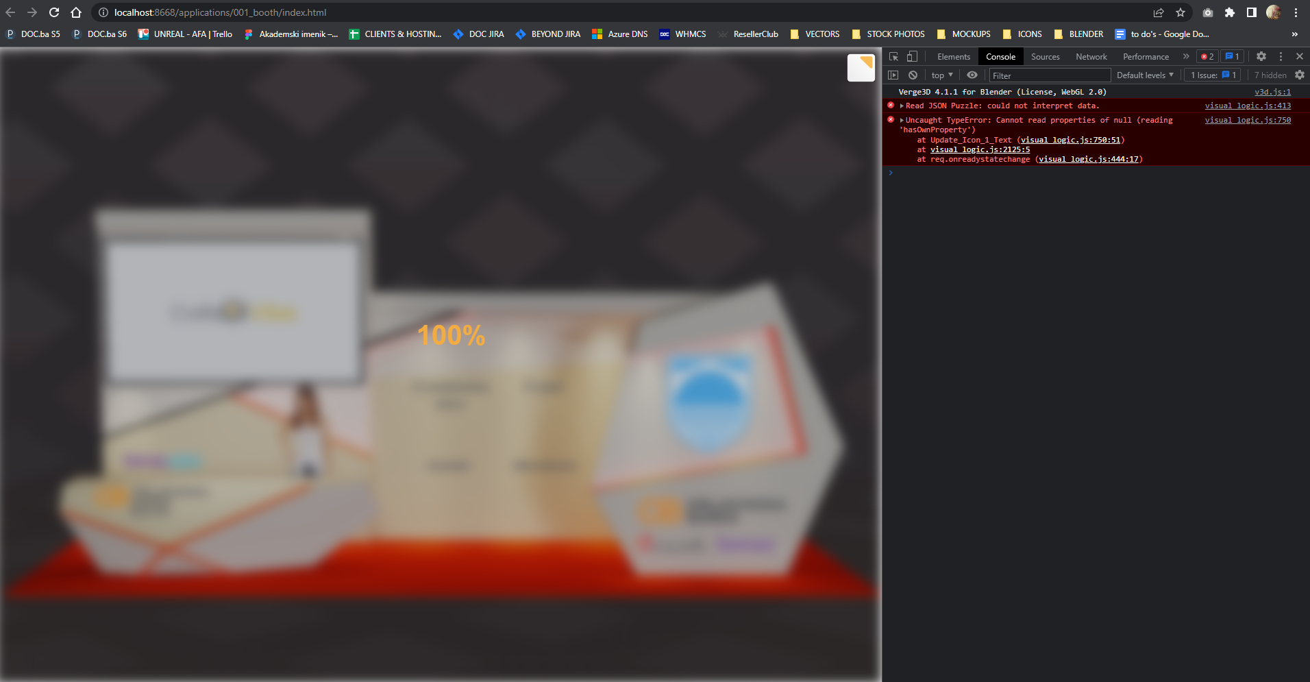

    Now i have another problem, so i had to reexport gltf’s and i did that and now i have another error which will be attached to this post.
    So now i cannot read data from json like i could on 3.9.1

    Yeah,that was it. Figured it yesterday but forgot to reply here for that. Thank you very much for help guys. Now everything works like a charm.
