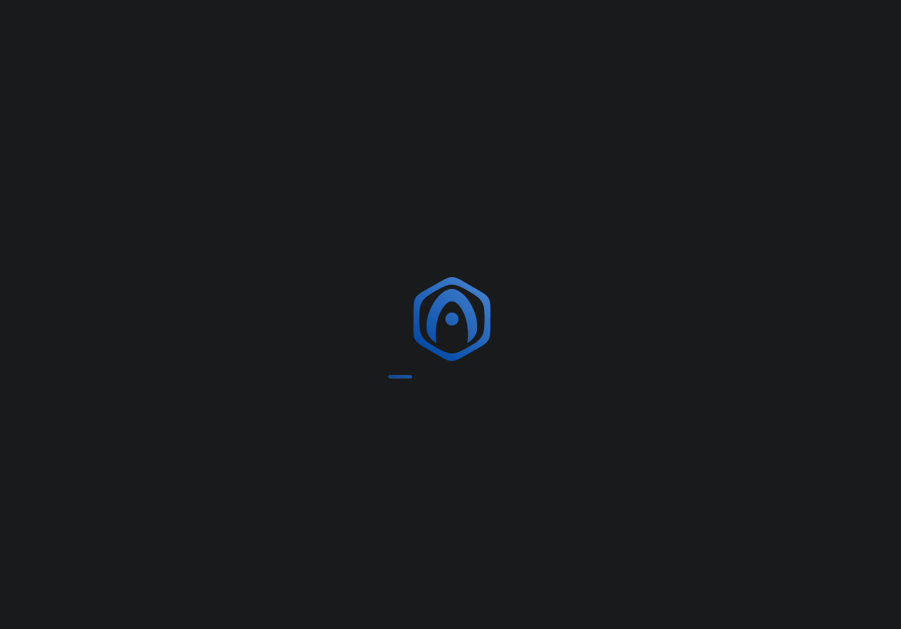

    I took an old project folder and copy pasted it into verge3d app folder in documents.
    – it showed in verge3d app list alright
    – updated the app by clicking update from operations
    – clicked on run app from runnables menu
    – it shows a frozen loading screen then just automatically downloads the apps bin file.
    why the app is not loading?
    picture shows where it just get stuck and downloads the apps .bin file…
