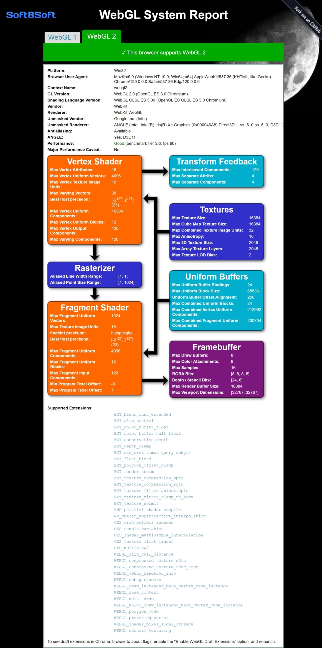

these devices come with Intel XE graphics, though it won’t be super-performant, most Verge3D demos should work seamlessly with it. Can you please provide content from these pages:about:gpu
See also if https://get.webgl.org/ cube rotates well.
2023-12-11 at 6:48 pm #69088
xeonCustomerThe WebGL cube rotates fine. Attached is the screenshot of the output requested.
