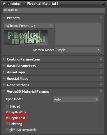

    I bought the Verge3D for 3ds Max Essential Material Pack and put “alluminium” and “steel” material on my object. The material hides colored parts of my object depended from the viewangle.
    Pic1: Dark part are colored with Verge3D for 3ds Max Essential Material Pack material
    Pic2, Pic3: The object in sneakpeek/vergeapp view
    what did i wrong? :unsure:

    here for example the lower part of my object, it’s got the same problem.

    Hi Edgard,
    In your file the materials “Steel” and “Aluminium” have their “Depth Write” and the “Depth Test” options disabled for some reason.
    If you enable those options then the materials will be rendered fine.
