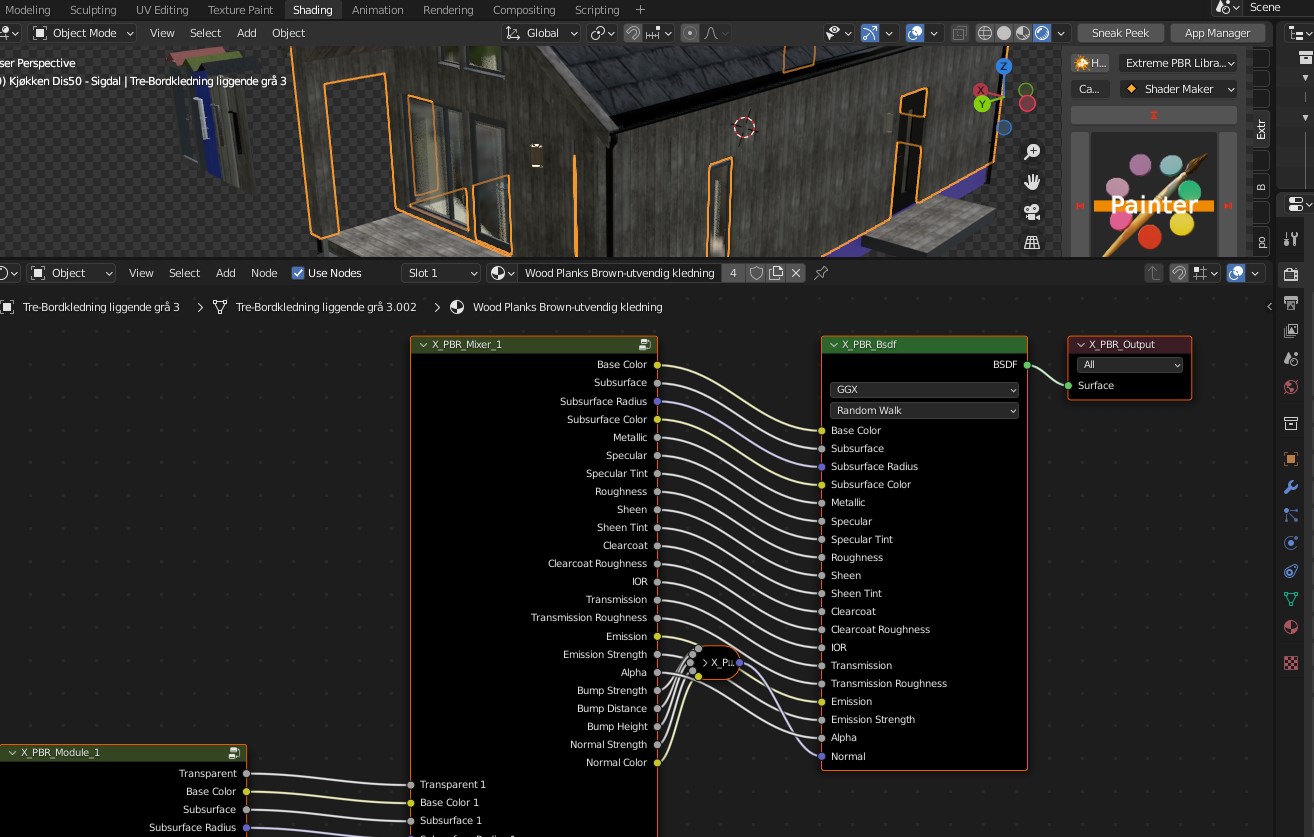

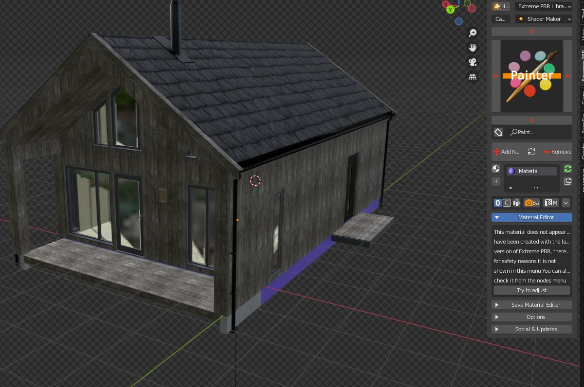

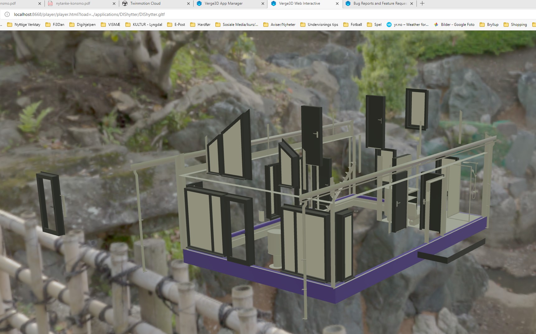

    In Blender it did wonders for me, and it speeds up my workflow enourmously. But now, when trying to create an app for configurating some cabins, It turns out that the material set-up included with the Extreme PBR add on is making my mesh invisible when starting the gltf file.
    The parts visible have either no material, or just a simple Principled BSDF material (the purple foundation)
    As you can see from the third screenshot, the add on creates different X_PBR_Mixers, which probably causing the issue.
    Is there a workaround or is this a common issue when using additional add ons togehter with Verge3d?

    We looked at the file and we reproduce crash, I think it ust be fixed, but the materials are so complex so even one will freeze any app to death, better not to use this addon.
