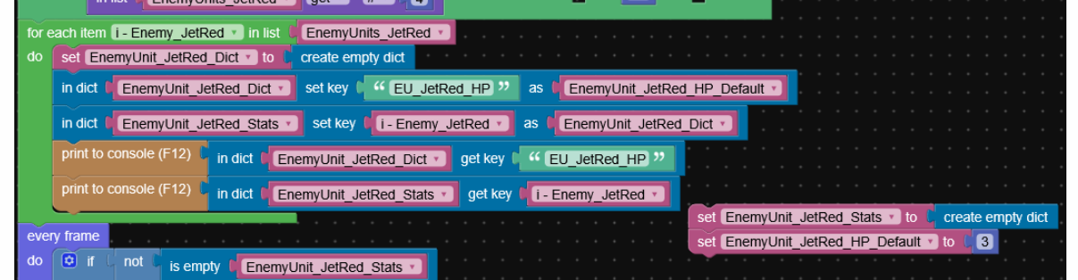

    c4cc
    I made the change as indicated in red. Still not working
    430878484-289536107492906-2424992886442237375-n
    #71459
    Use debugging. See the console log.

    c4cc
    Sorry for late reply. I did try to use debugging, still no change
    oile46x1
    #71533
    Your stats dictionary is empty. You did some mistake when creating a list of clones. Debug every step.

    c4cc
    Debugged:
    oile46x1
    oile46x1
    It says undefined, yet for some reason, you didn’t define the enemy clones for clone in the testapp, yet it works?

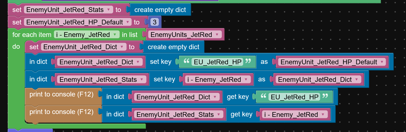

    #71565
    c4cc
    I just placed them BEFORE the loop. You placed those variables AFTER the loop.
    I placed them before the loop too now, yet I can’t get the individual clones to be removed as you did?
    #71566
    BEFORE the loop!!! Not inside the loop! You absolutly don”t understand what you are doing? :scratch: Just forget it. I’m out, I can’t help you.
    #71569
    c4cc
    Sorry for the stupid-ass mistake, I was stressed out just now doing stuff. Finally fixed it, it works now. Thanks for helping me man. :good:
