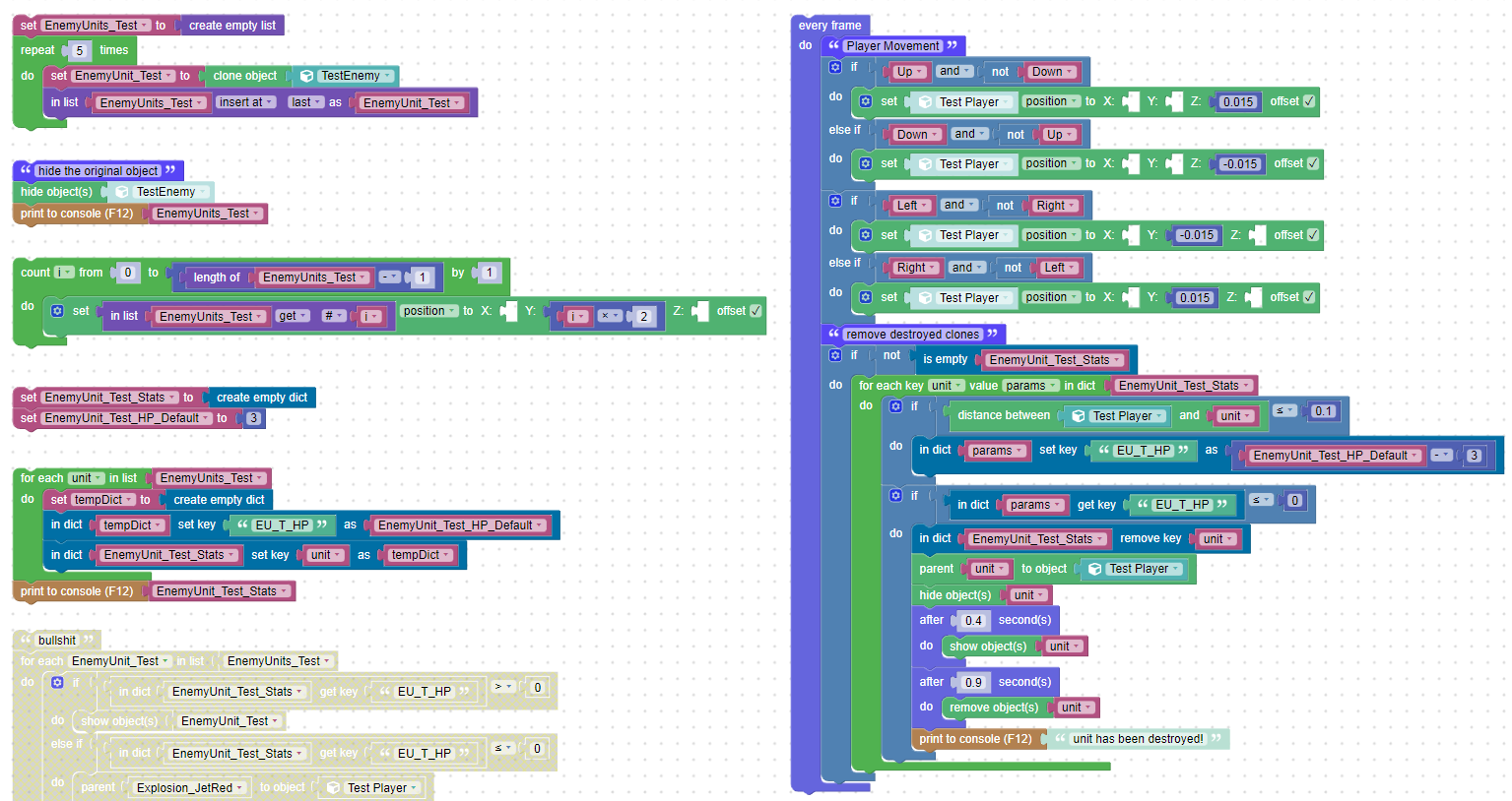

2024-03-07 at 2:11 pm #71402
c4ccParticipantDone, here is a test app as per attachments. Puzzles:
Basically, I want clones as individuals to only disappear and explode when they come into contact with the red object (player). Not all disappear together. How do I do this?
2024-03-08 at 5:55 pm #71423kdv
ParticipantShould work exactly like here https://v3d.net/trh
2024-03-09 at 7:13 am #71446
c4ccParticipantThanks for the reply. Sorry for being late.
While the individual clones do disappear when touched, their explosions follow around the player. I’d like the explosions to remain in place where the clone is removed.

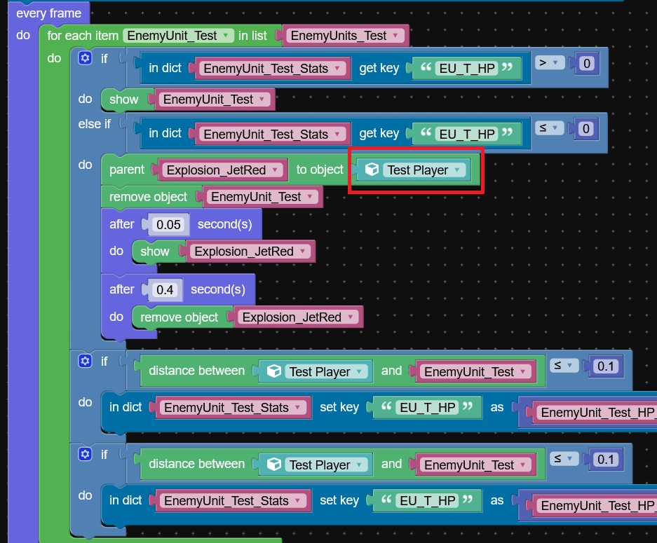

2024-03-09 at 10:17 am #71447kdv
ParticipantRemove one puzzle and they won’t follow. It’s initially your puzzles and it’s you who added this following.
2024-03-09 at 10:29 am #71448
c4ccParticipantFound the problem.
I’ll try this out and let you know ASAP, thanks
2024-03-09 at 10:33 am #71450kdv
Just remove the “parent to object” puzzle. Why did you add it? It’s not needed at all in this case.
2024-03-09 at 3:27 pm #71452
c4ccParticipantMy bad. I was so tired, I failed to see that mistake

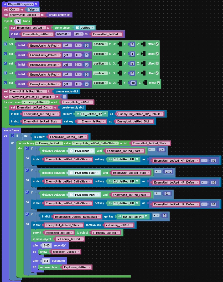

2024-03-09 at 9:01 pm #71453
c4ccParticipantShould work exactly like here https://v3d.net/trh
Attached is the variant of what you posted here. Yet not only could the clones not disappear when individually touched, the clones’ template went missing for some reason. What went wrong?
2024-03-09 at 11:23 pm #71455kdv
ParticipantYour logic went wrong. See the last loop with more attention.
