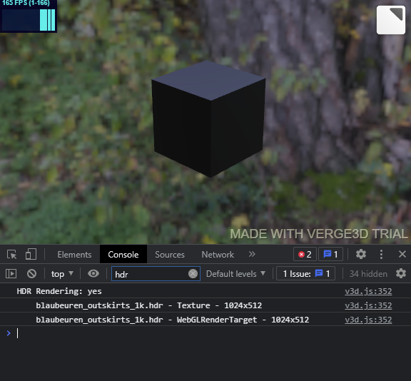

    Localhost shows texture properly while remote server shows dark cube.
    no error

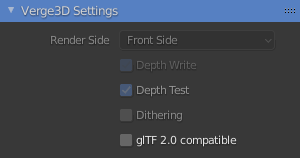

    glTF 2 disabled
    Any ideas how to correct his issue? :unsure:
