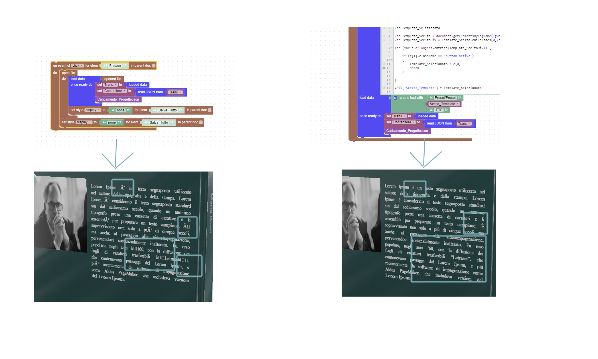

CustomerHi all,
the program that I am creating allows to save some parameters and variables in a text file which is the image of a JSOn.
The problem, as you can see from the attached image, is that the same file if I load it from the server shows the characters correctly; if, on the other hand, I load it from the local (browse), it changes accents and other characters. How can I fix it ??thanks !

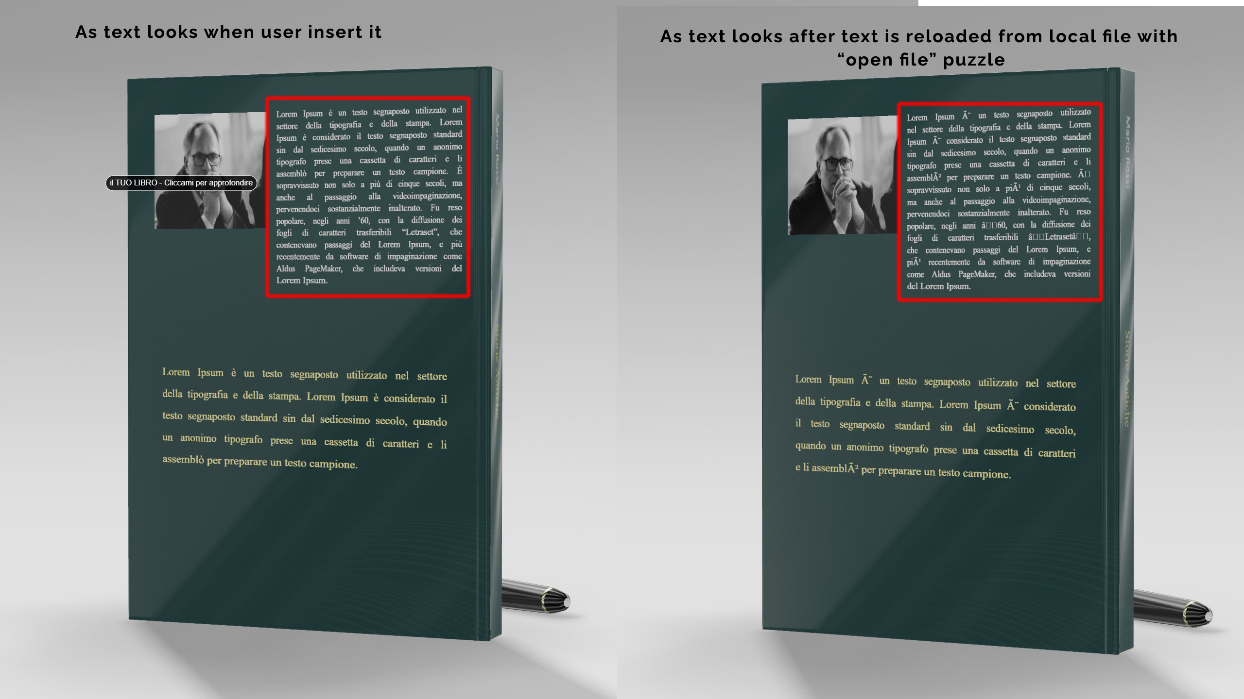

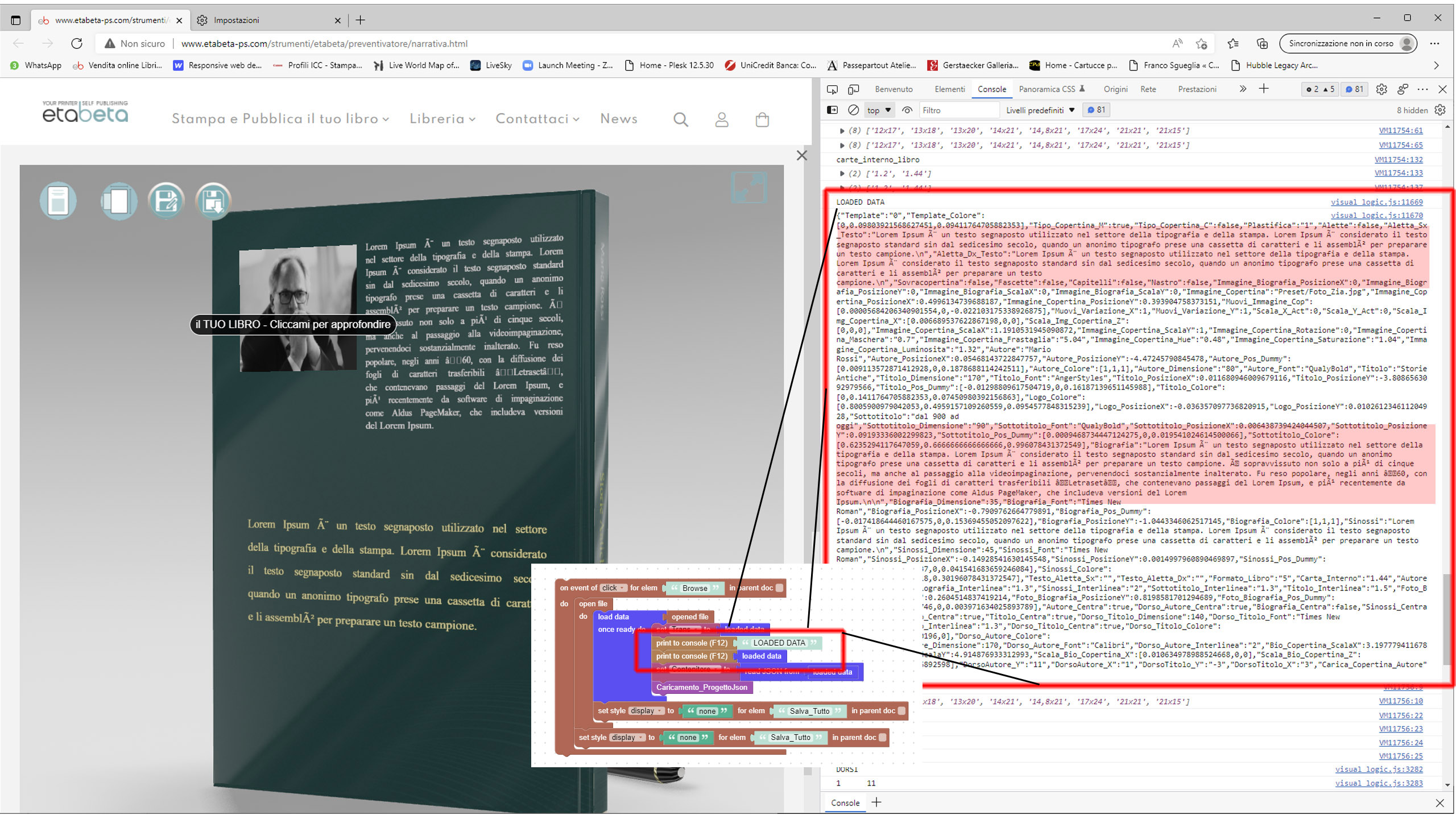

Yuri KovelenovStaff2022-03-23 at 11:13 am #50549fsguegl
CustomerI probably expressed myself badly.
I have attached a zip file to you which contains:
confronto1.jpg:
image where you can see the text being entered and the text as it
where you can see how the text looks after loading in the
inspection where I put 2 “print to console” containing exactly all
the uploaded file and where you can see that the characters are
not encoded correctly.FILE_SAVED.ETB
It is the file where all the data is saved and it is the same one
that was loaded in the example I showed you. You will notice that
the characters are correct and that the format is UTF8Attachments:
