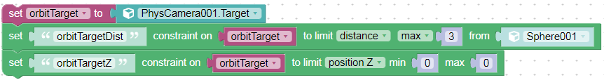

2023-04-04 at 10:46 pm #61708kdv
ParticipantUse the
constraintpuzzle
https://www.soft8soft.com/docs/manual/en/puzzles/Animation.html#limit_transformNot perfect but better than nothing )))
https://v3d.net/hrtPuzzles and JS coding. Fast and expensive.
2023-04-04 at 11:01 pm #61709
vjecht169CustomerNot perfect but better than nothing )))
https://v3d.net/hrtWow, but ahemm, how did you get the data of my file?
and more important: can you give me also the puzzle?
I tried it with the limit distance but it didn’t work ;)
Perhaps because I’am still a beginner…2023-04-04 at 11:04 pm #61710kdv
ParticipantWow, but ahemm, how did you get the data of my file?
Simply downloaded the files
and more important: can you give me the also puzzle?
You’d better place your town more symmetrically relative to the sphere’s center.
And fix the geometry
